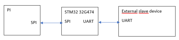

Hi all,
I have a setup with Pi and STM board. The Pi acts like an SPI master, the STM is setup as SPI full duplex slave.
The SPI input and outputbuffer are the same size, what i want is that when i receive x bytes from the pi, i send back the first x bytes of the SPI output buffer back .
I can receive data from the Pi with no issue's, but when i put data into the DMA SPI outputbuffer , this data is not send by the slave(STM) the next time the Pi initiate an SPI communication.
I use HAL library and setup the STM like this :
in main(void) ->

At the logic analyser i see correct data at MOSI and MISO lines when the pi sends the first SPI package.
But at the next SPI packages from the master (Pi), there is no data anymore at MISO (spi_buf_out), this line stays 0.
How do i instruct the HAL library to send back the contents of spi_buf_out every time the Pi starts a SPI communication?

it finally works, your tip lead to the solution. Thank you . I summarize the solution for other people .
The HAL lib is not ideal for this setup, i would recommend other engineers to write their own code to acces the registers , getting this right took at least as much time then starting from 0.
the setup :
The Pi is SPI master , the STM SPI slave , each SPI package is forwarded to the UART, some external device answers. This answer is given back the next SPI packet initiated by the Pi.
0693W00000DnVB5QAN.pngDe code :

You need to call HAL_SPI_TransmitReceive_DMA for every transaction. Or set it up in circular mode.

call HAL_SPI_TransmitReceive_DMA for every transaction -> does not work
circular mode. -> then the output shifts all the time,
Every time the pointer of the SPI outputbuffer is shifted with the number of bytes received by the PI. So for the first communication the pi send 5 bytes and receives the first 5 bytes from SPI outputbuffer, the next communication the pi sends 5 bytes and receives byte 5 till 9 from SPI outputbuffer.
How do i instruct DMA to start every time from byte 0 ?
By setting the Tx DMA transfer size to 5.
HAL_SPI_TransmitReceive_DMA() does not support separate Tx and Rx size, that's the limitation of Cube/HAL. You'd need to accept it (e.g. copy the 5 bytes of data manually to your positions in buffer); work around it somehow; or not use it and write register-access based programs.

SPI sends as many bytes as it receives, whether you want it to or not. There is one clock for the two data signals. Send 9 bytes at a time instead of 5 if you're receiving 9.
waclawek.jan
You did not tell us which STM32 are you using.
When you set up and enable DMA for Tx for the first time - presumably calling HAL_SPI_TransmitReceive_DMA() - the SPI Tx triggers the DMA as it has empty buffer/FIFO, and DMA fills up that buffer/FIFO (depending on the STM32 model and the SPI settings). So, if you afterwards disable DMA, the first frames are already in the SPI and are transmitted when master starts clocking. If master is clocking while DMA is disabled in your "workaround", and the SPI runs out of transmittable characters, it keeps repeating the last one - that's what you are probably observing.
You have also probably incorrectly synchronized master and slave. Toggle a GPIO output when you enable the SPI/DMA in STM32 and observe it together with the SPI signals.
S.Ma
Principal
First prepare a TX and RX slave buffer. As slave doesn't control the SCK, set the buffer in cyclic mode, no spi data transfer interrupt. Now, to synchronise the start stop of messages, use NSS as EXTI interrupt, say rising edge for the slave to process incoming.message and prepare next to go outgoing message.
If your SPI has fifo, reset (not disable) the SPI and reconfigure it to flush the clogged fifos. Once you reach this point, you are out of the woods....
