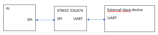

Hi all,
I have a setup with Pi and STM board. The Pi acts like an SPI master, the STM is setup as SPI full duplex slave.
The SPI input and outputbuffer are the same size, what i want is that when i receive x bytes from the pi, i send back the first x bytes of the SPI output buffer back .
I can receive data from the Pi with no issue's, but when i put data into the DMA SPI outputbuffer , this data is not send by the slave(STM) the next time the Pi initiate an SPI communication.
I use HAL library and setup the STM like this :
in main(void) ->
uint8_t cnt=0;
  spi_buf_out[cnt]=cnt++;
HAL_SPI_TransmitReceive_DMA(&hspi2,spi_buf_out,spi_buf_in,SPI_SIZE);
At the logic analyser i see correct data at MOSI and MISO lines when the pi sends the first SPI package.
But at the next SPI packages from the master (Pi), there is no data anymore at MISO (spi_buf_out), this line stays 0.
How do i instruct the HAL library to send back the contents of spi_buf_out every time the Pi starts a SPI communication?

In dma cyclic mode, as a slave, the transmit fifo is always filled. When Nss goes high, sck stopped with 3-4 byte ready to shoot out at next exchange.... if you use hal, thing maybe more tricky as a sw state machine is implemented... try deinit, then rcc spi reset, then init again. If the spi version has a flush fifo control bit, test it.
STM32G474RET
The response is shifted by 3 bytes, the first 3 bytes are invalid, the 4th and following bytes are correct every SPI communication.
I cannot figure out how to solve the 3 bytes shift.
This is the code now and a situation sketch.

it finally works, your tip lead to the solution. Thank you . I summarize the solution for other people .
The HAL lib is not ideal for this setup, i would recommend other engineers to write their own code to acces the registers , getting this right took at least as much time then starting from 0.
the setup :
The Pi is SPI master , the STM SPI slave , each SPI package is forwarded to the UART, some external device answers. This answer is given back the next SPI packet initiated by the Pi.
0693W00000DnVB5QAN.pngDe code :
