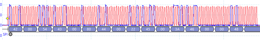

When I have a look at the transmission:
All bytes are right until the 46 00 00. The next should be 48, but is 00. From then, all bytes are wrong. The strange thing: If I set a breakpoint befor the SPI_Transmit command and make one step forward, it works:

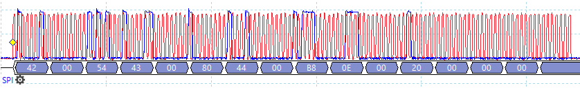

My idea was that it has something to do with a full buffer. So I reduced the number of bytes. The strange thing: Only sendig 16 bytes gives:
The B8 is the first wrong byte. But increasing now to 17 bytes:
0693W000001t2jvQAA.pngAt this point, my buffer theory makes no sense anymore because this is a correct transmission.

spiDataSend is a local array. It's on the stack. Once the function exits, that space is reallocated by the next function.
To send data through DMA, the buffer you're sending need to remain valid until the transmission is done. Use a global buffer instead. Or a local static buffer.

Hi
Thanks for your answer. Make sense.
Problem solved.
