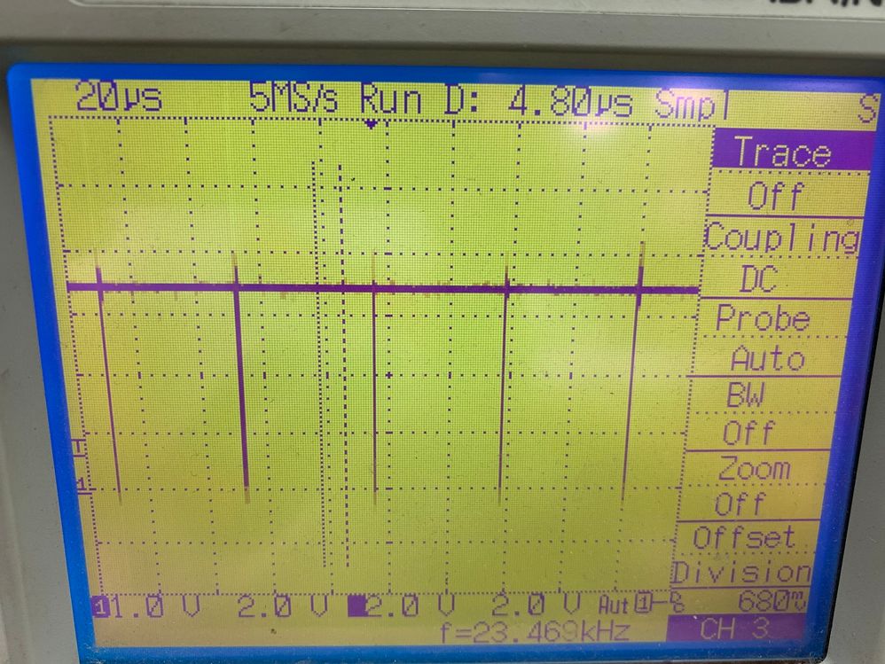

I tried to modify the example code X-CUBE-PWM-DITHR, I do not understand why aDitherTable recalculate the table of values max is 2047.
Please look the image of the oscilloscope on duty cycle 2047.
AN4507 Page 6 say
PWM-Effective_Resolution = PWM-Resolution + PWM-Dither_Resolution =11+1=12 bits=4095.
Therefore, from my understanding, duty cycle max should 4095.
bellow are the parts of the example code which were modified

Please correct me if my reading is incorrect.
waclawek.jan
Because the table contains values to be loaded into TIMx_CCRx, so they can't be higher than TIMx_ARR.
