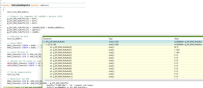

Hi everyone,

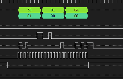

Im currently trying to use SPI with DMA mode on STM32U031G6 with an S2LP,
In this specific case I want to obtain the number of bytes present in my FIFO (10 bytes here), but the problem is that my reading through DMA mode does not work.
Below is the data that I analyze in SPI using a logic analyzer :
we have the read command (0x01) + the FIFO status command (0x90) + the command (0x00) where I get my response 0x0A or my 10 bytes.
What I don't understand is that the read_1_registre_DMA function returns 1 on the 3rd data item that I want to read as below :
Below is the function where I give my 3 Tx commands and where I expect 3 responses in return for Rx but the data is not correct for RX[2] (3rd element, or for me I should find my 0xA):

RX[2] does not have the expected value.
Do you know that RX[0] and RX[1] are being received correctly?
You observe RX[0] and RX[1] have the expected values after the transfer. But might they have had those values before the transfer? Can you put e.g. 0xff into all of them prior to the transfer to test this?
Understanding if any bytes are received correctly will help diagnose where the problem might be. For example, do you set SPI_CR2_RXDMAEN as well as SPI_CR2_TXDMAEN ?
Quentin_27
Thank you for your reply,
I try to add as you say Rx[0 - 2] = 0xFF
but i have the same result :

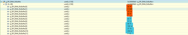

What makes me doubt my implementation of DMA is that after reading my 0xFD register, which contains the number of elements in my FIFO (which I can see on the logic analyzer...),
I set the number of elements read to 10 and called my DMA function, which reads my FIFO. And surprise:
My orange data corresponds to what I would have wanted while reading 0xFD (number of elements and the blue data are indeed the data I would like to have in my FIFO..)
There's a sort of offset, but I don't understand the reason because I call my "S2LP DMA INIT" function every time before using my DMA functions, which initializes the DMA with the addresses of the arrays to be used.
Thanks for your time.
