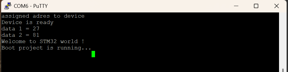

  printf("data 1 = %x \n\r", aRxBuffer[0]);
  printf("data 2 = %x \n\r", aRxBuffer[1]);
Screenshot of the prints that it made: 

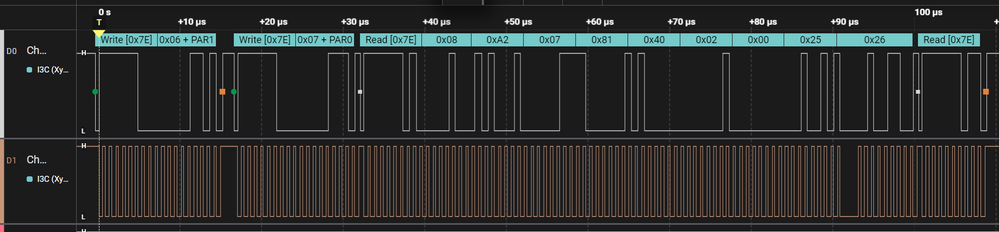

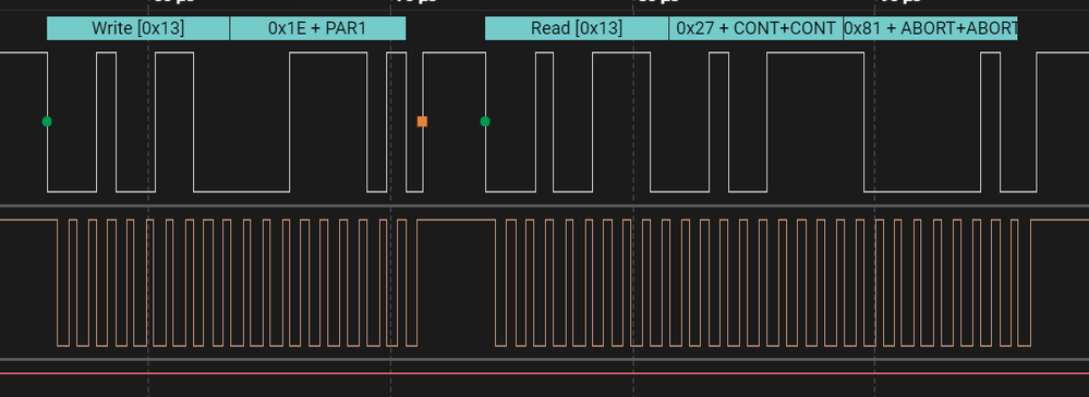

Screenshots from my logic analyzer:
Assigning adress:
trying to read:
