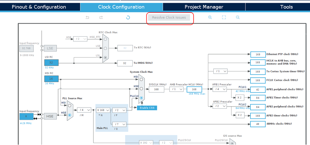

Hello @DJ1,
Have you tried using CubeMX? By default, using Nucleo-F401RE SYSCLK is configured to reach 84MHz.
