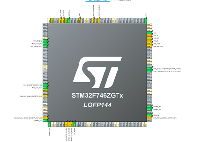

This is my pin configuration:
My UART2_RX pin is PA3, TX pin is PA2
My UART3_RX pin is PD8, TX pin is PD9

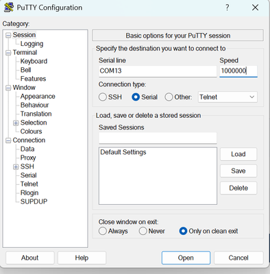

This is my PuTTY terminal configuration, although I don't think that should be the factor here:

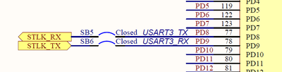

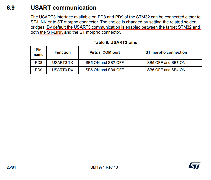

What board do you talk about ?
Most probably, the UART3 pins of the MCU are connected to the ST-Link adapter, and printf works via the VCOM interface provided by the debug adapter.
If you want to use another UART, you need to attach a USB-to-Serial adapter (or something similiar) on your own.
> However, when I switched the value of uartHandlerDebug to huart2, and I rerun the code, nothing is printed on my PuTTY terminal.
And checking both endpoints is not a very detailed analysis either. Check the UART.2 Tx pin output on board level with a scope or logic analyser.
mƎALLEm
If you are using NUCLEO-F746ZG board, that's normal. USART3 is connected to STLINK-VCP  (Virtual ComPort), while USART2 NOT.
From the bord schematic:

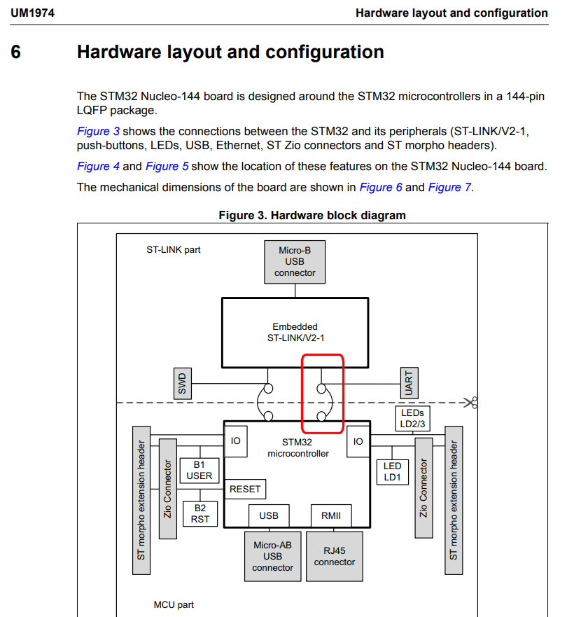

Hi, sorry for that, I have added the details to my post. I am using STM32 NUCLEO-F746ZG. The board is connected to my PC via a simple Micro USB cable.
@Andrew Neil wrote:
If you're using an ST board, with built-in VCP (Virtual COM Port), then you will need to make hardware changes for that to use a different UART - see the User Manual and/or Schematics for details.

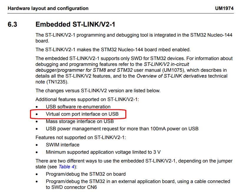

I am not very sure whether my board has VCP, but based on what I just read online, I think it does, since I don't have any other hardware that is connected between my laptop and the STM32 board.
So I am assuming there is no way for me to use any uart other than uart3 by changing like code/pin configurations, and I will have to like change some physical connections on the board to do so?

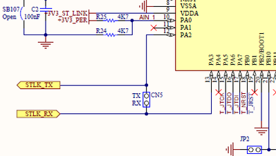

is45
Thanks everyone for the help! I have understood the problem now
If you need to use USART2, you need to connect USART2_Tx and USART2_Rx to respectively to STLINK_Rx and STLINK_Tx  over CN5:
But you need to keep USART3_Tx and USART3_Rx pin not initialized (Hi-Z).
@is45 wrote:
not very sure whether my board has VCP, !
The User Manual is the place to check that:
https://www.st.com/resource/en/user_manual/um1974-stm32-nucleo144-boards-mb1137-stmicroelectronics.pdf#page=26
via: https://www.st.com/en/evaluation-tools/nucleo-f746zg.html#documentation
