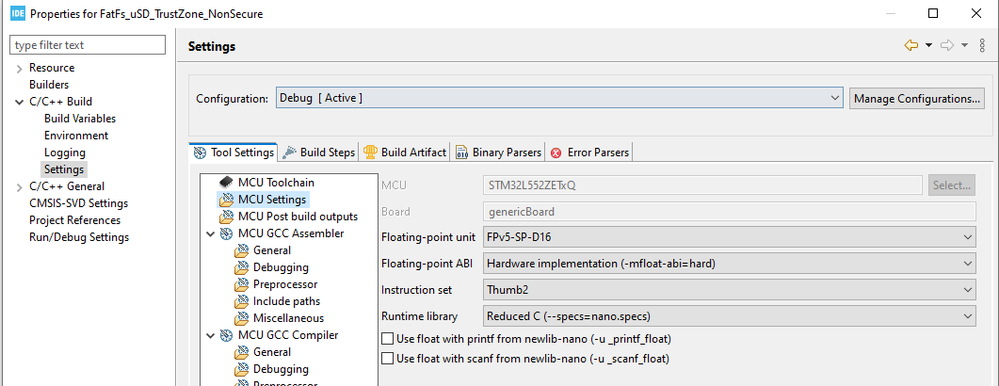

Thanks SofLit, I tried to use one of the FatFs_uSD_Standalone examples but it would not run because it was using the wrong processor and I don't know how to change it to a STM32L433.
The settings for MCU in the project properties are greyed out and cannot be changed...
You need to start from scratch using CubeMx to initialize the needed peripherals mainly the SDIO + Adding FatFs and populate your project by inspiring from the example.

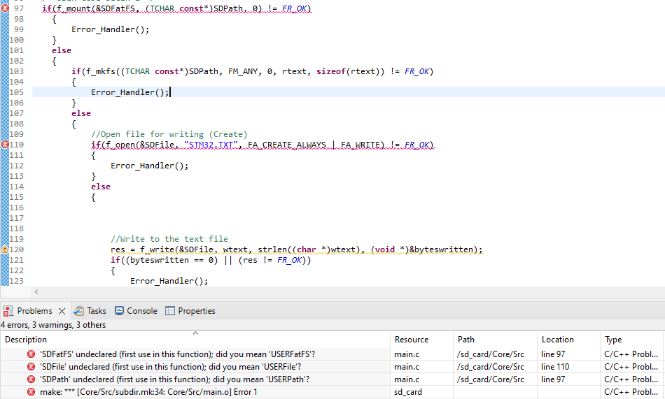

Thanks SofLit,  I followed the youtube video but get the following build errors...
The only difference between the youtube video and my project is that I am using the NUCLEO-L433RC-P (whereas the video is using the STM32F746G-DISCO).
I have to use SPI peripheral as the interface, because the L433RC does not have the SDMMC peripheral
