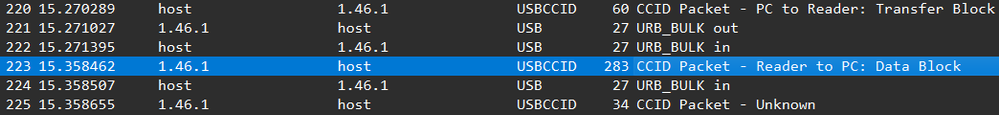

Ayoub-Marghoub
The first ten bytes of the first chunk are reserved for the transfer header; 54 bytes remain for the data.
The first chunk contains 54 bytes of data, and the following three chunks contain 64 bytes of data, totaling 246 bytes of data. To send 253 bytes of data to the computer, another chunk is needed to contain the remaining seven bytes.
When I capture the transfers with Wireshark software, I find that the computer only received 246 bytes of data. It didn't wait for the fifth chunk; it completed the transfer directly after receiving the fourth chunk.

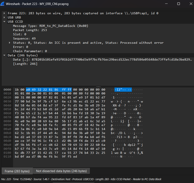

My firmware is based on this ccid usbd driver https://github.com/STMicroelectronics/stm32-mw-usb-device/blob/master/Class/CCID/Src/usbd_ccid.c .
The issue that I face, the PC finishes receiving data immediately after receiving 256 bytes (10 bytes of header + 246 bytes of data). when I want to send to pc 253 bytes of data + 10 bytes of header (263 bytes in total) by splitting (64 bytes by 64 bytes) the PC finishes receiving data immediately after receiving the fourth chunk which is 256 bytes (10 bytes of header and 243 bytes of data), It doesn't wait for the fifth chunk, which carries the remaining 7 bytes of my data which arrives in an unknown message despite the fact that I define the size of the data to be sent as 253 bytes. Images 1 and 2 show these details captured by wireshark software.1122
