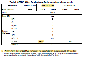

Why are you planning to use SPI instead of SDIO? is there any constraint?
Does the STM32L433 have SDIO ?
If it does, I still need a driver for the SDIO so that it can communicate with the SD card
Does an SPI or SDIO driver have to be written from scratch using the 400+ page SD specification or is there some example code ?
It seems you're using the NUCLEO-L433RC-P which has 64 pin package with SMPS. Unfortunately, and according to the datasheet, this package does not support SDIO feature but you can use SPI instead:
