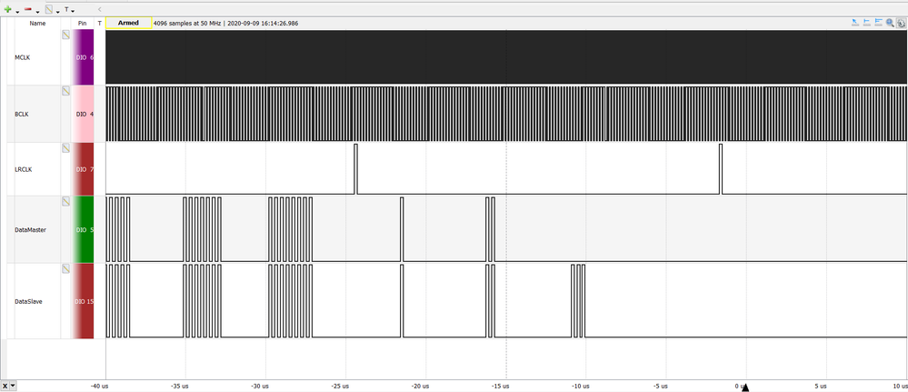

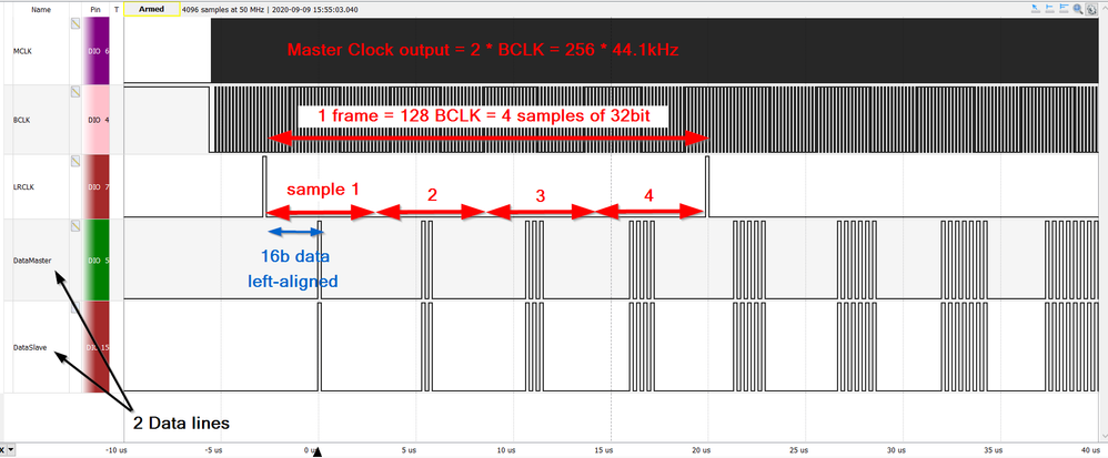

When I start the SAIs I get that:
So far so good, you can see both data lines are in sync, and also that the data is in the right place in the frame (since this is TDM, the DAC will send the samples to different outputs according to their position in the frame).

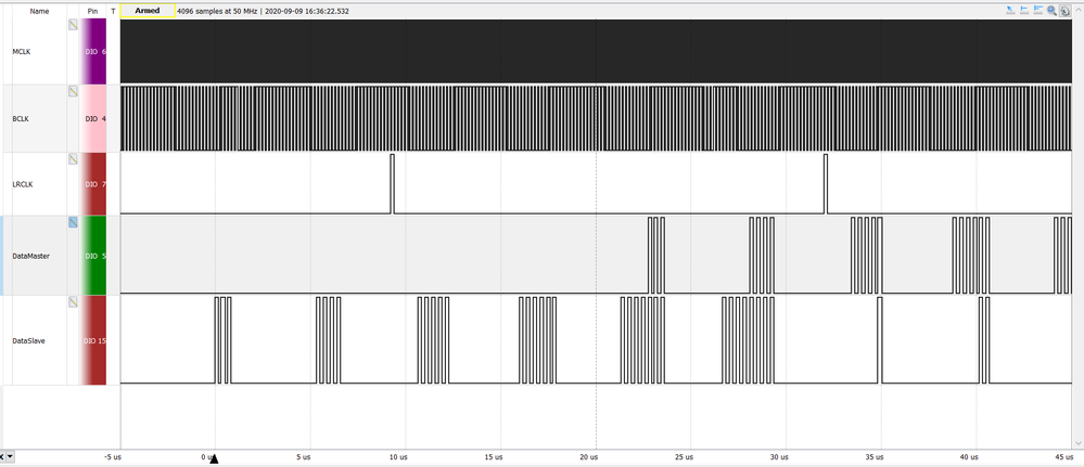

Then I press the button (calling HAL_SAI_DMAPause) and it does not (always) stop at the end of the frame, nor does the two data lines stop at the time (again: not always).
When I press again (calling HAL_SAI_DMAResume), and it seems the DMA/SAI make sure that the data within each frame is at its place, but since one SAI starts transmitting a bit before the other, then the other come one frame later sometimes, like here:
