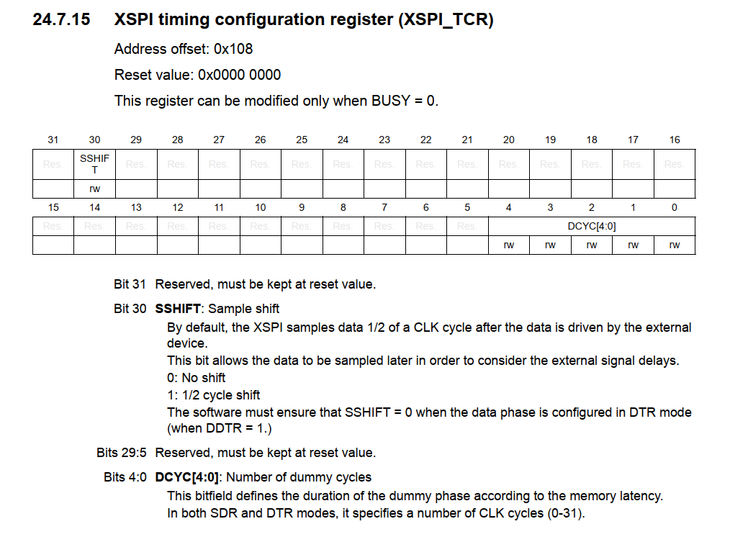

I'm working on a project using the STM32H7R3L8H6H MCU with a PSRAM chip connected via HEXASPI to XSPM1. I'm encountering massive issues with the PSRAM initialization, which I described in a different post. I found a discrepancy between the RM0477 Reference manual documentation and the STM32CubeProgrammer during my tests.
The XSPI_TCR register is described like this in the RM0477:

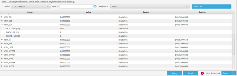

If I open the STM32CubeProgrammer register window, I find a DHQC flag on the register bit 28 position.
This bit is set to 1 all the time, and I have no information about its meaning.
Can someone please explain the function of this flag?

The DHQC is not supported by the XSPI interface for STM32H7RS MCUs.
So, the RM0477 is correct and DHQC should be removed from bit list, STM32CubeMx XSPI parameter settings and STM32H7RSxx_HAL_Driver.
