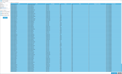

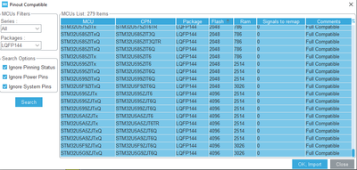

Hello @AndyCrosher and welcome to the ST community :smiling_face_with_smiling_eyes:.
I suggest you use the CubeMX that will list pin-compatible parts (with flash and ram details of each MCU).
Load your chip, configure it if you want, then go to Pinout -> List Pinout Compatible MCUs:
Best Regards.
