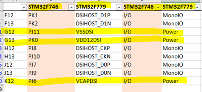

‎2024-08-16 4:20 AM
Hello @STTwo-32 ,
I checked in CubeMX tool.
Tool suggest compatible MCU is STM32F779NIH6 against STM32F746NGH6.
But if, I compared both datasheets then I found there is a pin type is change.
refer below capture
So, please provide your inputs.
Thanks,
Jignesh Karena
‎2024-08-16 5:43 AM
STM32F779NIH6 is not due to the DSI pins. CubeMX shouldn't be telling you they're compatible here.
STM32F777NIH6 looks to be pin to pin compatible.

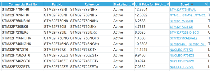

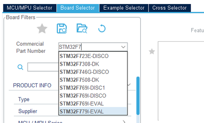

There is no eval board for STM32F777NIH6.
From STM32CubeMX, here are your options for ST boards for STM32F7 chips:

‎2024-08-20 3:56 AM - edited ‎2024-08-20 3:57 AM
These are the available boards for STM32F7 series (excluding Nucleo boards)
There is no Eval board for this exact part number STM32F777NIH6.
The nearest part number is STM32F779NIH6 which has an Eval board: https://www.st.com/en/evaluation-tools/stm32f779i-eval.html
