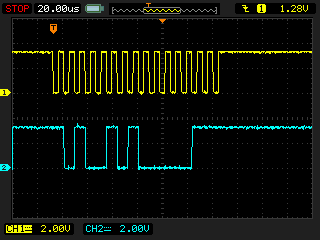

I was able to output the waveform shown in the attachment using Receive Only Master.
However, no data is being received(tmp). Why is this?
The process is performed in the following order:
HAL_SPI_Receive_IT(&hspi2, tmp, data_size);
HAL_SPI_Transmit(&hspi4, g_rx_temp_register, data_size, 1000);
hspi2(Receive Only Master)
hspi4(Transmit Only Slave)
About the waveform in the attached image
1ch hspi2 clock
2ch hspi2 MISO

Why are you doing two transfers?
which one is shown by your scope trace?
Why is the first one non-blocking (interrupt-driven), but the second is blocking?
The HAL_SPI_Receive()  will not have completed when you call HAL_SPI_Transmit() - so the HAL_SPI_Transmit() will be returning an error.

Is that what you meant, this is the scope of hspi2 (receive).
The top is the hspi2_clk pin and the bottom is the hspi2_MISO pin.
This is a prime example!
You just posted the screenshot, but we have no idea what it represents
