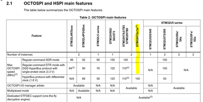

‎2023-07-12 7:00 AM
Hello @Jurni_JasteD ,
Thank you for bringing this typo to our attention.
I confirm that ,for STM32H72x/3x, the Max OCTOSPI speed Regular-command SDR mode / Regular-command DTR mode with DQS HyperBus protocol with single-ended clock (3.3 V) values are missing in AN5050 rev8 table2.
The correct Max OCTOSPI speed values for:
-Regular-command SDR mode is 140MHz.
-Regular-command DTR mode with DQS HyperBus protocol with single-ended clock (3.3 V) is 100MHz.
This issue is reported internally.
Internal ticket number: 154620 (This is an internal tracking number and is not accessible or usable by customers).
Kaouthar
