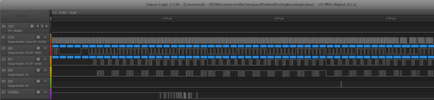

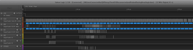

Here is the Logic analysis we are seeing for both the Fast Read Quad Output and Fast Read Quad I/O commands. They both receive the first 16 bytes of good data and then get the same bad data later down the line, random bytes but consistent random bytes. Note: for all reads we are reading the first sector of the Winbond chip (4KB) which contains 16 pages (256Bytes) each populated with values 0-255. This data is known good as we successfully read the data out using the Fast Read command before trying the Quad Read Commands.
Logic Analyzer of Fast Read Quad Output
Logic Analyzer of Fast Read Quad I/O

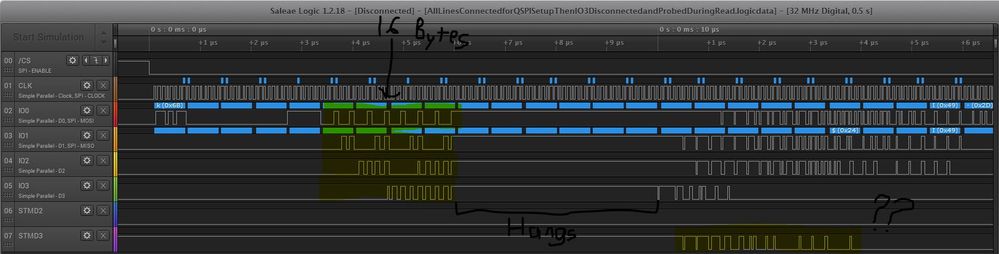

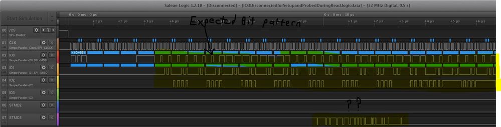

We have also conducted some testing that might be of interest.
One thought we had was that the handling of the WP and HLD lines were not being switched to high impedance correctly. To test this, we disconnected the IO3 from the Nucleo board and probed both the IO3 on the Winbond chip and the Nucleo board with the logic analyzer to see all the data transmission that is happening. For the first test we had the IO3 line connected during initialization and then disconnected it and probed the data on both sides the results of this are below
Around when the bad data occurs there is some sort of communication coming from the Nucleo board on the STMD3 line. We also tested if we did not have the IO3 line connected during the initialization. The results of this are below.
In this test it seems we were seeing good data during transmission on IO0, IO1 and IO2. It can still be seen that the Nucleo board is sending something across STMD3/IO3 at about the same time +10 microseconds.

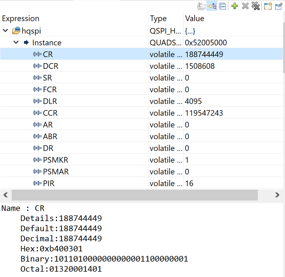

What about sample shift, i.e SSHIFT in QUADSPI_CR?
‎2021-10-04 12:00 PM
Here is what I am seeing in the hqspi registers. I have set Sample Shifting to the default (None) but have tried using the shift by half cycle and have not noticed any difference in performance.

For the Quad problem: Do you observe wrong data already on the pins with your LA or only the in data returned be the QSPI interface? From your description it's not totally clear to me. Unfortunately the screenshots from your LA are much too small to recognize anything. And, for the read you might check both memory mapped and indirect one. The 16-byte limit indeed sounds like some problem with wrap around, either in the flash or in the QSPI fifo.

To clarify I preform 1 write and then try to read it in single data mode using fast read which correctly reads back all the data confirming that the data on the chip was written. I then try the Quad-I/O or the Quad Fast Read, both of which only get 16 bytes of expected values it seems to hang and then get a bunch of noisy data that looking at the logic analyzer seems like it might be coming from the nucleo boards side. I've attached larger LA captures in case it helps point to some obvious clues.
IO3 Connected During Initialization
IO3 Disconnected During Initialization
Thanks for the notes on things to change and for pointing me towards the errata sheet. There are two examples in there that could be causing things to hang. I will try out these changes this week and come back with the results of those changes.
‎2021-10-06 1:54 AM
Really weird ... During dummy phase IO0-IO3 should switch from output to input but here the previous levels are kept constant (possibly due to capitance). Hence: Maybe you could repeat the *very* same test (upper one, all pins connected) again once with pull-ups on IO3-IO0 enabled, once with pull-downs enabled. The pull-up/pull-down setting doesn't interfere with alternate setting of the GPIOs. This would show easily wheter any of IO3-IO0 is driven by the H7 or the flash (we couldn't distinguish which one, but anyway) during dummy phase and more importantly during the "silence phase" after the first 16 bytes. The most surprising fact is that there seems to be total silence on *all* four data pins.
