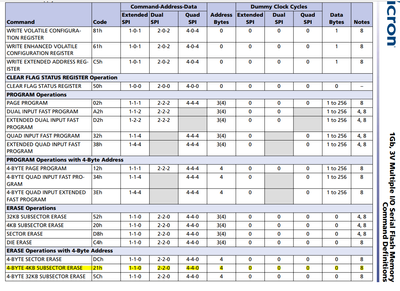

The block erase operation does not seem to function as expected. After executing the block erase command, the memory contents remain unchanged. Additionally, modifying the dummy cycles in the erase function impacts the communication stability with the NOR flash chip. Specifically:
  • Dummy cycle = 1: Erase function is sent, but the memory is not cleared.
  • Dummy cycle = 0: Communication with the chip fails, resulting in status register and other commands returning incorrect values.
Despite following the MT25QL01GBBB datasheet closely, the block erase functionality is not performing as intended. Below are the details of my setup and the code being used.

The dummy cycle must be configured depending on the memory datasheet.
As mentioned in the memory datasheet, for erase operation, the dummy cycle is equal to 0.
Are you using 4-BYTE 4KB SUBSECTOR ERASE 0x21 operation?
Before 0x21 operation, the WRITE ENABLE command must be issued first. Also, 0x21 operation support only 4 address bytes as mentioned in the above table.
I recommend you to refer to QSPI_MemoryMappedDual example and check your configuration and settings. This example describes how to erase part of the QSPI memory, write data in IT mode and access to QSPI memory in memory-mapped dual mode. This example has been tested with STM32H747I-EVALUATION BOARD and MT25TL01G memory.
Did you find an issue when using 4KB SUBSECTOR ERASE 0x20 operation?

A 128MB device is going to need to be in 4-byte (32-bit) addressing mode. The 3-byte (24-bit) is only good to 16MB/128Mb
Two die mode requires you loop reading the Flag Status Register twice, and BOTH must flag ready. You can't use AutoPolling of the Status Register on one die.
Erasing can fail/complete immediately if the BP (block protection) bits are set in the Status Register, there's also a failure flag in the Flag Status Register.
There isn't a Mass Erase, you must erase each die, selected via the address
