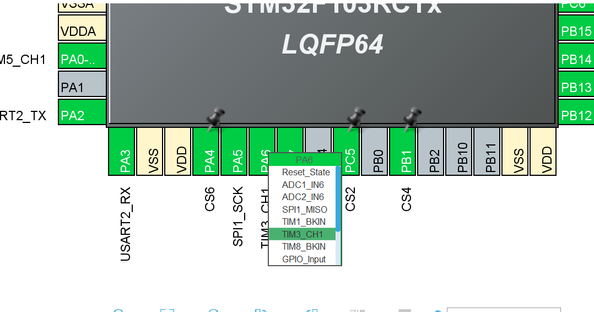

I want to generate 6 PWMs using channel 1 of timers 1,8,2,3,4,5. All of them are set the same way except ARR, PSC and CCR1 registers. However, it turned out that timers 2 and 3 don't have PWM signal on their pins. The content of registers for those timers are the same (checked during debugging). I also tried to initialize timers by writing directly to registers, with no luck. MCU: STM32F103RCT6. Here is the the initialization for timer 3, for example:
// ------------------------- PA6 settings ------------------------- // RCC->APB2ENR |= RCC_APB2ENR_IOPAEN; // Port A clock (PA6 - TIM3_CH1) GPIOA->CRL |= GPIO_CRL_MODE6; // PA6 speed MAX GPIOA->CRL &= ~GPIO_CRL_CNF6_0; // Alternate function Push-Pull GPIOA->CRL |= GPIO_CRL_CNF6_1; // ------------------------- TIM3 settings ------------------------- // RCC->APB1ENR |= RCC_APB1ENR_TIM3EN; // TIM3 clock TIM3->CCMR1 &= ~TIM_CCMR1_OC1M_0; // PWM mode 1 TIM3->CCMR1 |= TIM_CCMR1_OC1M_1; TIM3->CCMR1 |= TIM_CCMR1_OC1M_2; TIM3->CCMR1 |= TIM_CCMR1_OC1PE; // enable preload register TIM3->CR1 |= TIM_CR1_ARPE; // enable auto-reload preload register TIM3->EGR |= TIM_EGR_UG; // generate an update TIM3->CCER &= ~TIM_CCER_CC1P; // polarity: active HIGH TIM3->CCER |= TIM_CCER_CC1E; // Output signal enable TIM3->ARR = 11999; // period TIM3->CCR1 = 5999; // pulse % TIM3->PSC = 1; // prescaler TIM3->CR1 |= TIM_CR1_CEN; // PWM on
 I tried another STM32F103RCT6, but behaviour is the same. Is that hardware issue inside the MCU?
waclawek.jan
Unlike every other STM32, the 'F1 GPIO is not flexible, and you cannot have multiple peripherals which map to the same pin enabled at the same time.
Here, the conflict is probably with SPI1.

Dan_Ko
Hello Sarra,
If I set up TIM3 using CubeMX, should not it be remapped by default?
waclawek.jan
I disabled SPI and it worked. Thank you very much for your help! CubeMX seems confusing in that sense because it does not indicate any conflict when I enable SPI in transmit-only mode and want to use MISO pin for different purpose. Is that property of F1 series stated somewhere in datasheet or RM, so I can read about it?
