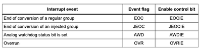

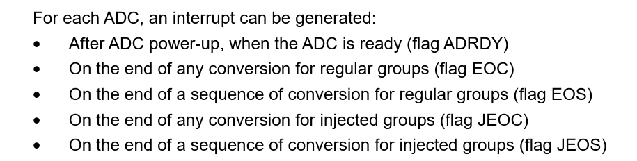

depends on your selection, what ISR you want/need:

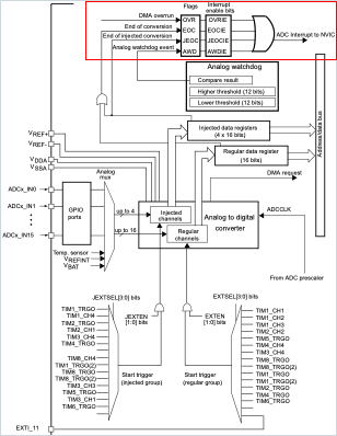

‎2024-04-01 7:18 AM
There is no EOS flag!
From the ADC block diagram
But, the End of Conversion (EOC) flag (in ADC_SR reg) can be triggered at the end of each conversion or at the end of a sequence, depending on the EOCS bit (in ADC_CR2 reg)
‎2025-01-16 7:36 AM
Close but no cigar. The OP wanted to know what to do in case of a multi channel conversion Setup.
I just tried that on a STM32F411 with four channels setup. The ADC-with-DMA is started every 100ms fro the TIM2 ISR. Both the TIM2 callback (starting the ADC) and the ADC ConversionComplete callback contain each their own "visit counter" tim_convs++ and adc_convs++;
And irrespective of what I configure in the CubeIDE ADC-setup, both values always rise in parallel!
So End of Single conversion (once per channel one would expect) and End of Conversiopn group (once per channel group) behave exactly identical.
=> in DMA mode ADC End-of-Single-conversion (one Interrupt, more precise one callback call per conversion) does not exists, behaviour is always "callback at End-of-Conversion-Group."
