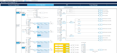

You configured PLL1 to have output frequency = 1600MHz, then IC1/SYSA = 800MHz.
But this frequency can only be reached in VOSHigh. Refer to RM0486 in section 13.6.2 Voltage scaling and DS14791 in  Table 24. General operating conditions.
In VOSLow, the SYSA frequency max = 600MHz. Here below the Clock configuration of PLL1 to update in your code, then regenerate the project.

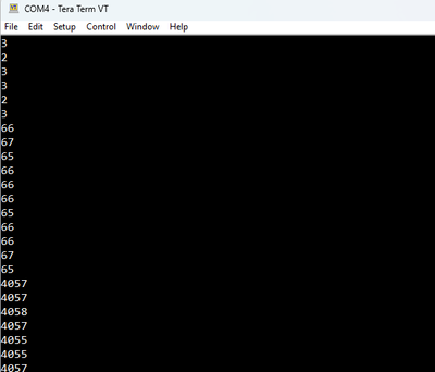

With these change, you will be able to read correct ADC conversions on PB10 when applying voltage 0 to 3.3V on Arduino CN7 A5 or on STMOD+ AN #13 from 0 to 4095 decimal values (see my serial terminal)

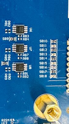

I don't know which is the PB10 pin on the STM package as it has a VFBGA structure and i can't access those pins. But I have checked that SB16 0 ohm resistor is present and it is soldered, which was necessary to enable that ADC.

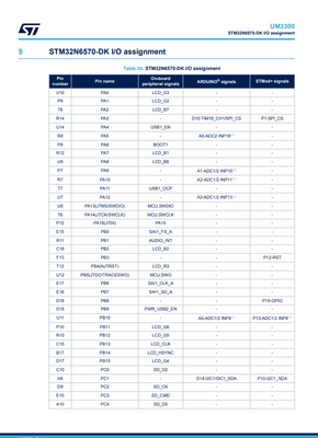

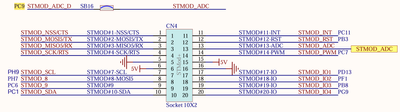

> ADC1/2 INP8 channel (PB10) using the MB1280C Fanout board (Pin 13)
Pin 13 is connected to PC9, not PB10. Or am I missing something?
Hello @athern27
I'm referring to UM3300 Table 13. STMod+ connector (CN4) pinout.
On the STMOD+, Pin #13 share PC9 (digital GPIO) and PB10 ADC. There are SB9 and SB16 to check.
In the MB1939 schematic, page 9, PB10 is also shared between STMOD_ADC and Arduino A5 connector.
If you need PB10 ADC on STMOD+, check if SB9 is soldered and SB16 must be open (to isolate PC9)
You can also use PB10 on the Arduino CN7 pin #6 (A5R).
https://www.st.com/en/evaluation-tools/stm32n6570-dk.html#cad-resources
You can apply an input voltage = 3.3V thank to the opamp U6B + resistor voltage divisor R83/R84 (which decrease 3.3V with ratio 0.45, the PB10 ADC input will see 1.79V)

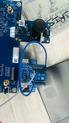

We desoldered SB16, and SB9 was soldered by default. We then supplied 3.3V to pin 13 of the STMOD+ connector (on the fanout board) using the 3.3V output available on the same fanout board.
Now, we are successfully measuring 3.3V on the A5 connector using a multimeter. However, the ADC values we are receiving are still around 1800–2000, which do not align with the expected values calculated using the standard ADC conversion formula.
We tried on ADC1 and ADC2 by setting PB10 as ADC1_INP8 and ADC2_INP8 respectively.I am attaching the screenshots of the connections made and attaching my project as well.
