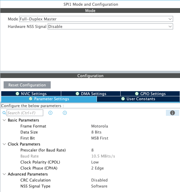

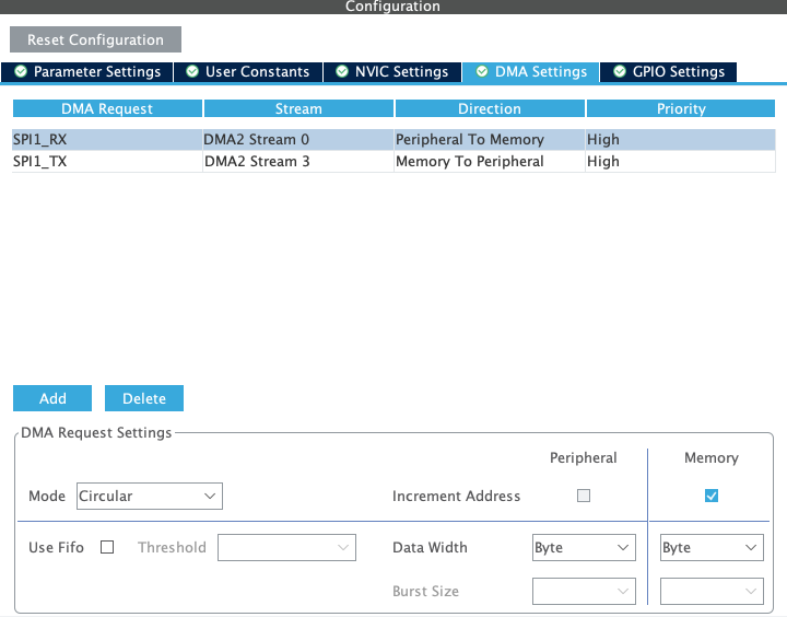

My SPI is configured like so:

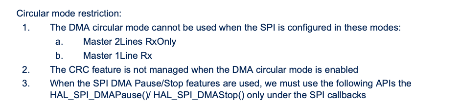

The HAL Reference Manual notes:

// IMPORTANT! On Page 1033 of the HAL Reference Manual,
// there's a note that says we can't use circular DMA
// with SPI with only RX data (which is what we want).
// To get around this, what I'm doing is creating a
// dummy TX buffer, and then using HAL_SPI_TransmitReceive()
// to simultaneously send and receive data. There is no
// physical TX connection here, so this does nothing really,
// it's just a workaround to allow us to do this DMA trick.

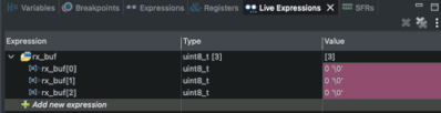

 Then I enter the debugger and monitor rx_buf:
Gif compression aside (the values change more rapidly than what is seen here), this doesn't look like meaningful information to me - the values only switch between 0 and 255, e.g.
I wonder if it is relevant to highlight that I'm doing this from within a freeRTOS task? rx_buf is currently declared a global within one of my tasks. It feels as though I am making a mistake with correctly writing to a memory location or something, but this is where I'm bumping up against my inexperience.

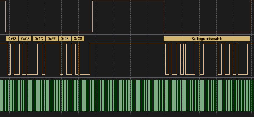

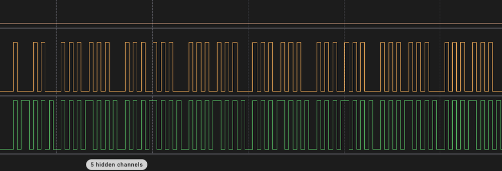

  • To your third question, I did that just now; the results offer some clues. At first, I see the sensor seemingly providing meaningful data. My logic analyzer seems to have trouble making sense of things, I think maybe because it's unclear where one transaction ends and another starts (but that's me guessing):

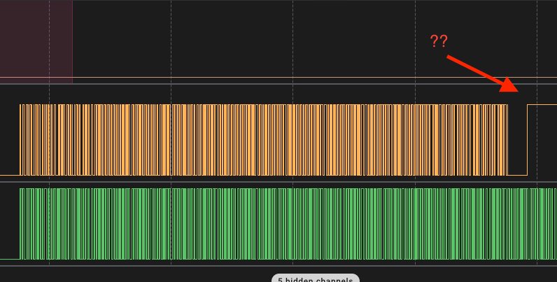

  • Then, after a brief period, it seems like the sensor stops providing output:

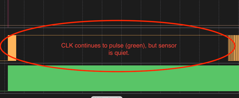

    It seems to stay in this state for a bit:
    Then finally starts pulsing what I'm guessing is an error signal:
All of this led me to realize that I never pull CS High again after each individual transaction (which is what I do when reading the sensor in a polling fashion). From Page 23 of the sensor's datasheet:
"The MT6701 SSI is shown in Figure 24, a data transfer starts when CSN is pulled to logic ‘Low’. The MT6701 transfers data on the falling edge of CLK, and the data transfer finally stops when CSN is pulled to logic ‘High’"

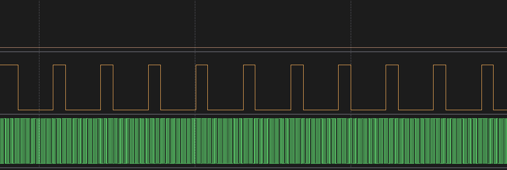

When inspecting things now with a logic probe, I see this:
 I wonder if what's happening now is that things are no longer properly synchronized - it looks like the SPI clock continues to run separately from me yanking CS high or low.
Stepping back: I wanted to try digging into this to learn, but am I choosing a poor test case for circular DMA? I can't tell if I'm using this as it was intended to be used or if I'm just inadvertently creating a bigger problem for myself.
