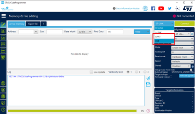

1. is there any tool (GUI) to update program using executable?
Using STM32CubeProgrammer tool

Hi, reading on program update is ongoing.
I tried using STM32CubeProgrammer and was able to program using ST-Link.
but I tried USB FS device with DFU, and STM32CubeProgrammer was able to detect USB and when connect is pressed...the bottom bar keeps on searching and never finishes...this is with STM32F469 discovery kit.
I tried loading "DFU_standalone" also but could see same.
Please any suggestions?
