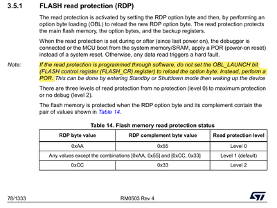

I agree with your assessment of what's happening. Although it's not documented, so we're guessing here.
Here's the relevant RM section:
4 REPLIES 4
The reference manual says to do a POR rather than launching option bytes if you set RDP through software.
Erasing and writing to flash (where option bytes are stored) takes some time, probably in the tens of ms range. How is IWDG configured that it's resetting so quickly?
You could also try reloading it in the while (true) look after launching option bytes. Unsure if that'll do anything.

Where is that in the manual? I didn't see it. Thats really my main problem. The OBL_Launch isn't really working.
My routine runs in RAM and the IWDG is serviced while waiting on flash to be free. This part works. But after issuing the OBL_Launch, it doesn't really launch and the iwdg causes a reset. Iwdg is set for 7.5ms.
I get really strange behavior when i try to debug this by port toggling. I don't see the ports for some reason. My guess is the OBL Launch puts the mcu in some mode but takes more than 7ms to complete. And this mode does not allow code execution so no iwdg servicing can happen even if running from  RAM.
I think I can try extending the iwdg timeout until i figure out how long it takes. If i set a port high just before the OBL Launch and low just after it what happens is the output rises but before it can even hit 3.3v it drops asymptotically to 0 in uS.

Makes sense. I wish they had put that in my manual for stm32g071. Would have saved me days?
