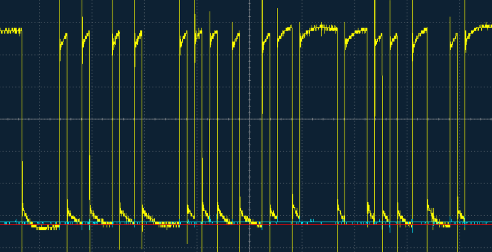

Here is an image of what i can observe :
The frame that we can observe is (Start bit in black, stuff_bit :(
  • 0000010010001001000001010100100010110111110111010100110001011111111111111111
If i remove bitstuffing, the begining is the same
  • 00000010001001000000101001000 (frame)    10110111111110101001100010 (crc maybe bigger with other '1')

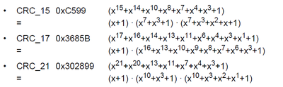

As you can see, the CRC seems to be bigger than 17 or 21. I made a test file that calculate CRC and tried everything :
- Using CRC17 with and without stuff in calculation
- Using CRC21 with and without stuff in calculation
- Using CRC32 with and without stuff in calculation
I tested every polynomial I could find :
- CRC-17 : 0x1685B (Wikipedia) /  0x3685B (CAN with Flexible Data-Rate, BOSH)
- CRC-21:  0x102899 (Wikipedia) /  0x302899 (CAN with Flexible Data-Rate, BOSH)
- CRC-32: 0x04C11DB7(Wikipedia /   0x302899(CAN with Flexible Data-Rate, BOSH) / 0x4C11DB7 (RM0455
Reference manual)
I can't find anything about the CRC of the CANFD in the manual of the STM32 (RM0455 Reference manual STM32H7A3/7B3 and STM32H7B0 Value line) and there is nothing on the internet so if anyone has an idea or knows what is the polynomial for CANFD, could you please help me.

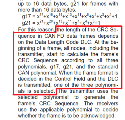

Meanwhile, I'm not expert of that subject, but didn't understand your feedback because this paragraph tells you how to calculate the CRC: the three CRC types (CRC_15/CRC_17/CRC_21) are calculated at the same time and one CRC type will be selected and transmitted based on the control bit and the DLC value.

Look at this whitepaper: https://datasheet.datasheetarchive.com/originals/crawler/bosch-semiconductors.de/d86e094dd180575f847791e56fe3d1f5.pdf
Also I've attached an article "CAN with Flexible Data-Rate" by Florian Hartwich, Robert Bosch GmbH
See section "4. Cyclic Redundancy Check"

So for me it is important to know what polynomial is used because i need to put it in my CRC block so i can made the division.
I have read the document that you have sent and i noticed that for the transmition of the CRC, there is "fixed bit stuff"  after every four bits of data. I made an excel of different CRC for different messages and i conclued that it seems to be the case:
The thing is, i don't understand why the crc is 21 bits ( i only have 1 byte of data) and , when i play a simulation, i still can't find the same CRC if i remove all the fixed bit stuffing (in yellow).
The polynomial that i use is x21+x20+x13+x11+x7+x4+x3+1 (the same as in the doc you sent)
