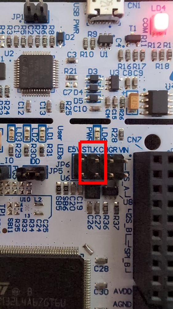

Hey. I tried to setup `printf` using the following forum post. I am using the `NUCLEO-L4A6ZG`.
Here what I've tried so far. I connected the `USART2` to the Pins `PA2` (RX) and `PA3` (TX):
(By default LPUART1 was configured and connected to PG7/8, since the forum post used USART2 I used it as well.)
After the configuration was saved, and the code generated, I used the code from the previous mentioned forum post. Here a shorter and with comments removed version:

Then I build it, created the Debug-Profile and ran/resumed it via the Debug-Mode.
I wanted to connect via PuTTY. I turned Flow Control off, and set the data bits to 7. Here are the settings:
When I select open I can connect, but the terminal stays just empty.
I not sure where the problem is. I would be very grateful if someone could help me.

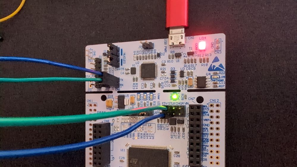

‎2024-02-28 3:02 AM
Sorry if i need to ask again. But does the the STLK_RX/TX refer to those two pins?
I tried to connect RX/TX to them like this. But it didn't work either:
I'm sorry for those dumb questions. Currently feeling totally overwhelmed by all the schematics and documentation. If there is a more straight forward way to configure printf i would of course do use it too.

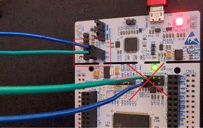

‎2024-02-28 3:06 AM - edited ‎2024-02-28 3:10 AM
Remove the ones crossed.
You have to use the one in rectangle and you have to connect UART2_Tx/UART2_Rx from CNx connectors

‎2024-02-28 3:14 AM
Okay now It works. Thank you so much for your time and patience!

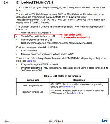

‎2024-02-28 3:39 AM
@mÆŽALLEm This is a common issue that comes up quite a lot.
As well as clarifying the VCP UART connection diagram (as already mentioned), I think the ST-Link section should specifically state what UART the VCP connects to, and cross-reference to the section with the details:
Perhaps also something could be added on "how to use a different UART" ... ?
‎2024-02-28 3:43 AM - edited ‎2024-02-28 3:43 AM
I think it's something managed in transversal. Each board has it's own UART (sometimes USART1, others USART3, others LPUART1 etc ..). So I think it's not easy to manage in the documentation.

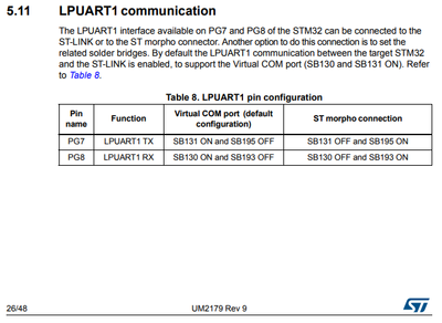

‎2024-02-28 3:59 AM
Fair, although the UM2179 here does specifically refer to LPUART1:
There should at least be a cross-reference from the ST-Link section to this section (or its equivalent).
‎2024-02-28 4:55 AM
Yes this is a specific section for this board while the other (I think) is a generic paragraph that implies all Nucleo boards.
Does this kind of specific paragraph available in all UM?:
