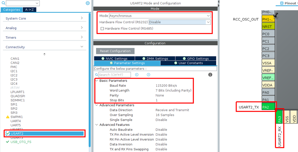

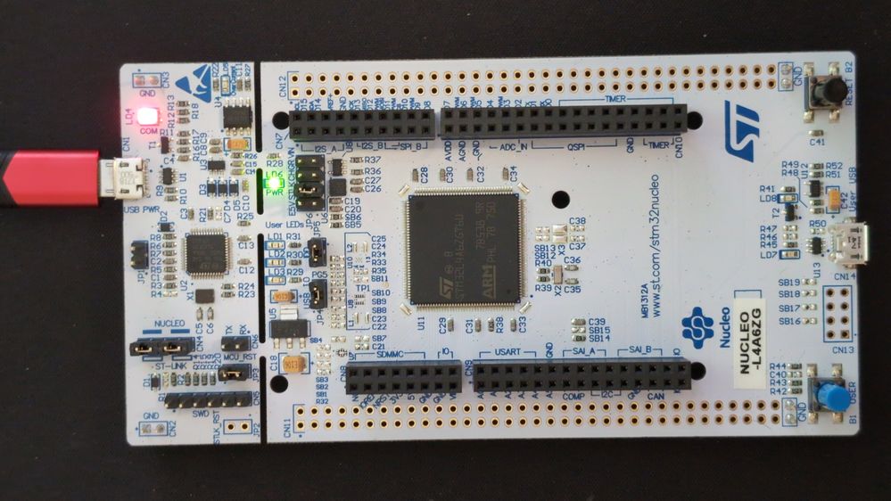

Hey. I tried to setup `printf` using the following forum post. I am using the `NUCLEO-L4A6ZG`.
Here what I've tried so far. I connected the `USART2` to the Pins `PA2` (RX) and `PA3` (TX):
(By default LPUART1 was configured and connected to PG7/8, since the forum post used USART2 I used it as well.)
After the configuration was saved, and the code generated, I used the code from the previous mentioned forum post. Here a shorter and with comments removed version:

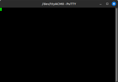

Then I build it, created the Debug-Profile and ran/resumed it via the Debug-Mode.

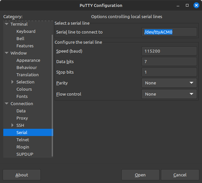

I wanted to connect via PuTTY. I turned Flow Control off, and set the data bits to 7. Here are the settings:
When I select open I can connect, but the terminal stays just empty.

mƎALLEm

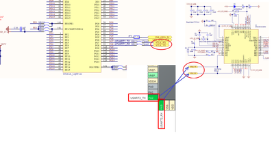

You need to look at the NUCLEO-L4A6ZG schematics from this link.
You need to connect USART2_Tx to STLK_RX and USART2_Rx to STLK_TX.
By default LPUART1_TX is connected to STLK_RX and LPUART1_RX to STLK_TX.
So your UART2 is not exposed to the virtual comport in STLink.
PS: make sure LPUART1_TX pin (PG7) is not configured. Keep it in analog input configuration.

Ok you said "(By default LPUART1 was configured and connected to PG7/8, since the forum post used USART2 I used it as well.)"
Did you connect USART2 to STLK_TX/STLK_RX lines of the STLINK block (replacement of LPUART1)?
And what is the config of USART2_TX gpio pin?
Sorry I didn't really understand what you mean by "Did you connect USART2 to STLK_TX/STLK_RX lines of the STLINK block (replacement of LPUART1)?", since I'm an absolute beginner. How can I check wheter it's connected. Is it something on the physical board or in the software?
I haven't change anything on the board so far:

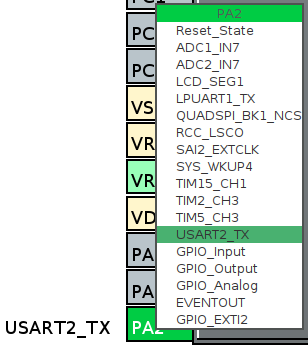

To the point "what is the config of USART2_TX gpio pin?" I just selected the PA2 Pin and assigned USART2_TX.

mƎALLEm
As @mƎALLEm  suggested, the schematics are the key to see what's connected to what.

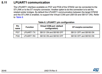

These things are also documented in the User Manual, UM2179:
This tells you that the default (out-of-the-box) configuration of the board is to have LPUART1 connected to the ST-Link's VCP.
Therefore, if you want to connect a UART other than LPUART1 to the VCP, you will first have to disconnect LPUART1, and then make the connections to your desired UART.
He can keep SB130 and SB131 soldered (as he's a beginner and can damage the PCB) but he must ensure that PG7 and PG8 IOs keep default GPIO pin settings (GPIO input).
