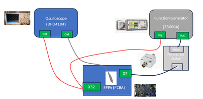

I want to generate the following specification of the burst signal from the STM32L073RZ board  , need to know is that possible? Or else need your valuable suggestion whether it is possible from other STM32 boards?
 Parameters
Values /Settings
Waveform
Sine
Offset
0V
Phase
0 deg
Amplitude
 2mV
Frequency
12.5MHz
Burst Cycle #
 150
Trigger
 External
Load Impedance
 50 ohm
26 REPLIES 26

Burst cycle they mentioned was "150". The below figure illustrates the connection.
Instead of function  generator , I need to use the signal generator board like STM32  / DDS modules . Please guide me.
Try to some prototyping. Generate 12.5MHz from your STM by timer or MCO. Design some passive filter which attenuates your signal to about 2mV, connect it to your oscilloscope (with 50R termination) and verify. If need, try to change parameters of your filter. If you are not satisfied with results try way with DDS (and possibly RF siwtch, if your selected DDS isnt able to "keying").
