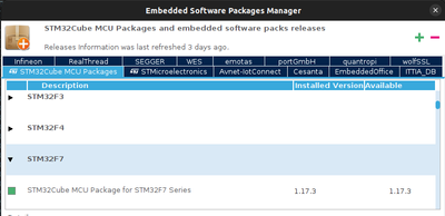

Here are the details of my stm32 cube environment.
Operating system: Ubuntu
STM32cubeIDE version details:
Firmware version : 1.17.3

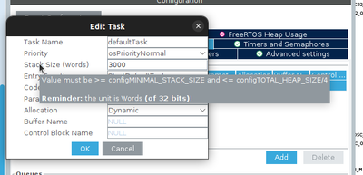

Hello @ak52 and welcome to ST Community!
After reviewing your project, it seems you have allocated an excessive stack size for your default thread—512 words should be sufficient instead of 3000. Additionally, you can remove the delay you added. With these adjustments, your application should work even if the Ethernet cable is plugged in after boot. Please let me know if this resolves the issue.

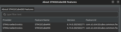

Version 1.18 of STM32CubeIde is buggy - upgrade asap to 1.19.

Hi @STackPointer64 ,
I will be needing that much stack as i will be running micro-ros from it and the procedure instructs to set the stack size to 3000 words, but this was indeed the main issue, once i reduced the size, it worked :) Thank you.

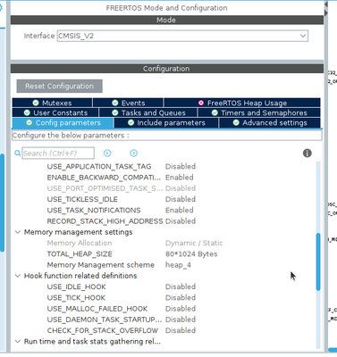

So instead of decreasing the stack size , I increase the TOTAL_HEAP_SIZE to about 80 KB.
80 KB to satisfy the < 80KB/4 condition.
Now my application works even if the Ethernet cable is plugged in after boot.
