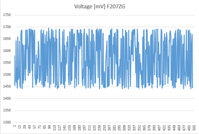

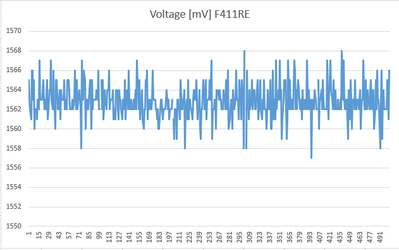

I need your help. I am currently writing my masther thesis and I need robust and not noisy ADC read. I am using Nucleo board in my project so I hope hardware should have no effect in my case. The problem is ADC quality. I've tested three different boards: F411RE(100MHz) F207ZG(120MHz) H745ZI-Q(400MHz). All boards were running with their internal RC clocks.
ADC for each one was configured in similar way i.e.:
- ADC clock around 7.5MHz,
- 12bit resolution,
- measurement frequency 10kHz (triggered from timer ISR),
- sample time around 15 cycles,
- polling method.
For test purpose I chose 1.5V battery to be measured and I realised that unfortunately only F411 returns stable voltage. I mean the noise was Vpp=10mV. Whereas the other mentioned boards delivered really unstable values (noise Vpp=250mV). I don't understand what is going on :frowning_face:

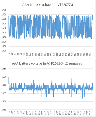

SOLUTION
Luckily I've found this post:
https://community.st.com/t5/stm32-mcus-products/fluctuations-in-adc-value-of-stm32h743-mcu/td-p/331487/page/2
The author of the solution said that Ethernet PHY causes the ADC noise problem and recommended to remove L2 coil which turn off this interface. I did so and below there are results before and after:
Standard deviation of measurement dropped hugely from near 90 to 1,5.
It seems to be problem with every H7 Nucleo board as each has PHY. The conclusion is that there is no way to use both Ethernet and ADCs, since ADC averaging/oversampling isn't possible in every situation.
