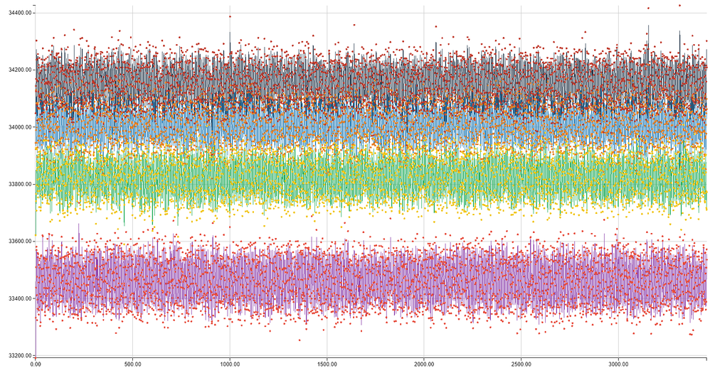

And then I've got the same high-speed (2 MSPS) raw data captures again:
as you see it still shows this aliasing affect, but it looks now way cleaner and more "pronounced" than it was before:
If using moving average filter using 2 samples, it improves slightly:
Trying to run ADC at its maximum sampling speed (5MSPS) did not help to figure out interference frequency, so it is higher than that.
As I've already mentioned in my previous post - you can not identify that this is aliasing of higher-frequency interference IF you do slow sampling. As in this 13kSPS example it just looks like Gaussian noise, because clock drift (PLL jitter) introduces a lot of phase noise to notice any aliasing patterns of 13kHz vs 25MHz interference.

In our case - the parasitic input was way beyond my Nyquist frequency of 1Mhz. If we zoom-in time scale of the first picture and plot it in MATLAB:
The parasitic signal is apparently at 5mV peak to peak range (100 LSB out of 65536 for 3.3V full range).

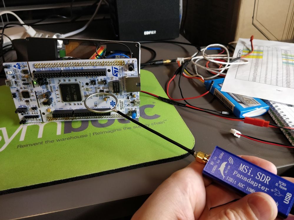

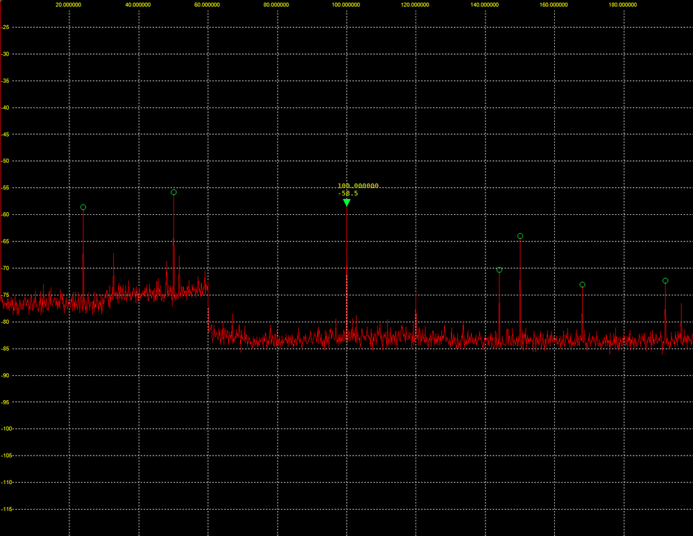

Got my MSi.SDR delivered, so made an H-field probe to see more what spectrum is radiated from Ethernet PHY chip:

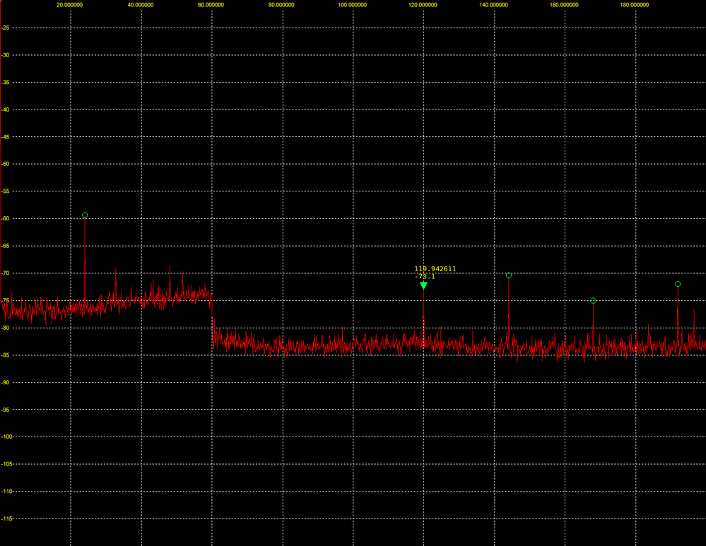

Using RSP Spectrum Analyser software, here is the spectrum when the probe is far away from the Ethernet PHY chip:
And this is when the probe is close as shown on the picture above:
0690X00000ApzM0QAJ.pngSo that 25MHz frequency (of the XTAL nearby Ethernet PHY chip) is actually multiplied by 4, so we have 50MHz and 100MHz components in radiated EMI.
