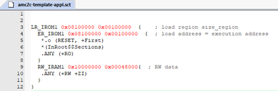

Hi STOne-32,

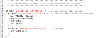

I re-run the tests with the load regions as you suggested, see following scatter file,
and things runs better. It is the right path to follow.
Now one test runs the same on both G4 and H7. The other two tests runs slower on H7 but the extra time has dropped to 1.5% and 5% which can be acceptable.

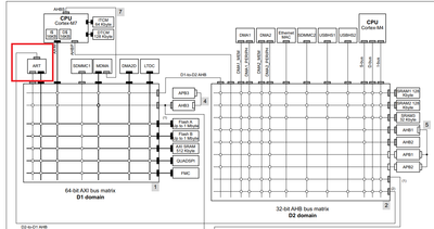

3- When you said "The CM4 of the STM32H745 is clocked at 200 MHz (and its CM7 at 400 MHz) and uses AHB SRAM1 mapped at address 0x30000000." Do you mean you're executing the code of CM4 from SRAM1? if yes I recommend you to use the address  0x1000 0000 for code execution.
4- Did you enable the ART for CM4/H7?

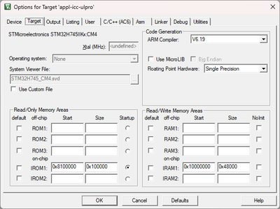

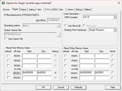

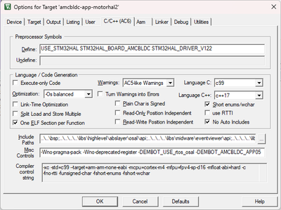

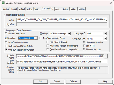

> 1- are you sure you have similar code optimization for G4 as for H7?
> 2- Are you sure you are not using math library instead of FPU for CM4/H7?
We have used the armclang v6.19 w/ equal optimization modes (now we have -Obalanced) and we has enabled the FPU as from following pictures.
FPU option for the CM4 of the STM32H745 and for the STM32G474 (below)
Optimization option for the CM4 of the STM32H745 and for the STM32G474 (below)

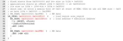

For the STM32H745-CM4 we execute code from FLASH and use AHB SRAM1 for data (that is mapped at address 0x3000 0000 and aliased at 0x1000 0000). I believe that using 0x3000 0000 or 0x3000 0000 is the same as they are aliases of the same bank.
Scatter file for the CM4 of the STM32H745 and for the STM32G474 (below)

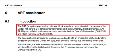

Yes, the code in our `HAL_Init()` is exactly the same as yours.
