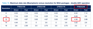

I would like to evaluated ADC of STM32H745. I would like to have 12bit 5.12MHz dual ADC. According to my understanding, I need to use model STM32H745II in 176 pin UFBGA to obtain ADC performance. Is there any board like nucleo, which can be used for evaluation?
@mosamasa wrote:
According to my understanding, Disco is based on STM32H745XI (240pin TFBGA). Maximum ADC rate would be only 4.38MHz.
Yes you're right according to the AN5354:
But, unfortunately, there is no other ST boards for STM32H745 with other packages.
The only available ST boards for STM32H745 are with LQFP144 and TFBGA240.
