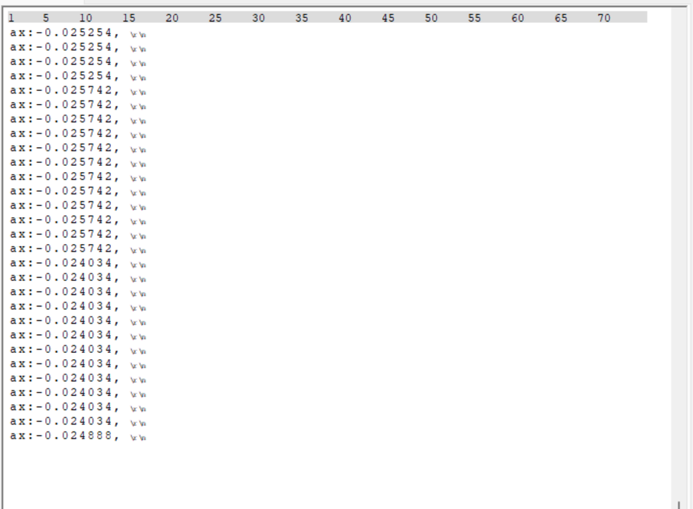

Hello, I've been battling with this issue for a while now and I'm hoping someone has done something similar that can help with my issue.
I have a STM32H745 board with an IMU connected. I'm accquiring the data over the M4 core and then trying to send it to the M7 core using the HSEM (hardware semaphore). I'm basing my work off the examples on the ST project [here](https://github.com/STMicroelectronics/STM32CubeH7/tree/master/Projects/STM32H745I-DISCO/Examples/HSEM/HSEM_ResourceSharing/CM7/Src).

This part seems to be fine, I see the data updates as expected on the M4. The problem arises when I try to retreive it on the m7 core. On the M7, I configure my MPU to be on cacheable and non-bufferable to prevent cache coherency issues.

Unfortunately, the data on the M7 side seems to repeat ever so often and I'm not sure why. A sample output is shown below.
I'm not sure if I'm making a very obvious mistake here. I've looked around and tried all sorts of tricks. The only one that seems to have worked is Tijen Majerle's [ring buffer implementation] but this doesn't seem to make use of the HSEM. I'm looking for a HSEM solution partly out of curiosity and partly for performance reasons down the line.
