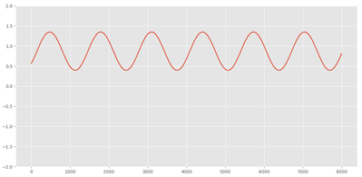

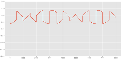

When I set the ADC sampling rate to 250KHz and the sine wave signal is 100Hz.
Here is the sampled signal I got:
When I reduced the ADC sampling rate to 125KHz, the sampled data is correct:

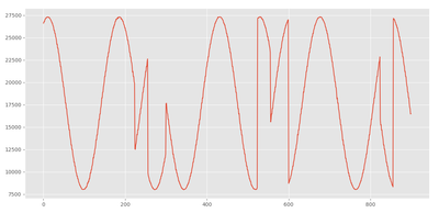

But I have verified the data in the DMA buffer is glitched instead of the read method.
Here is the graph by reading the u16_t value directly from the DMA buffer.
The input sine wave is 2KHz and the sampling rate is 350KHz
I'm not sure it's the issue of high sampling rate, it's only taking 175 samples per period of input signal.
I also checked the input signal is a normal 2KHz sine wave using oscilloscope.

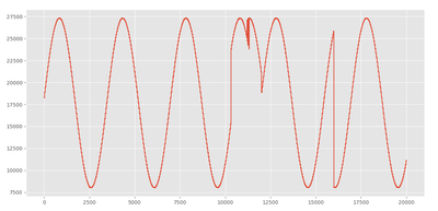

I just found that when I reduce the functions inside the half and complete callback.
The ADC is less likely to produce the glitch. Below is the code and graph.

With less functions:
void HAL_ADC_ConvCpltCallback(ADC_HandleTypeDef* hadc)
	CDC_Transmit_FS((uint8_t*)&adc_buf[BUF_LEN_HALF], BUF_LEN_HALF*2);
	adc_buf_counter++;
	HAL_GPIO_WritePin(GPIOC, GPIO_PIN_7, GPIO_PIN_RESET);
Glitches are less likely to occur, but they are still there.
