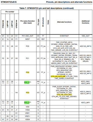

I am currently working on a H723 based HS USB device with external USB PHY (USB3320,USB3340,USB3300 tested).
While testing i have noticed that seemingly randomly between debug/flash cycles HS USB stops working with usually no activity on the bus but the HAL Phy setup usually still succeeds enabling the PHY but leading to an unknown device for the host.
After replacing the H7 everything works again indicating some internal damage. This has happened several times on different revisions each with other protection attempts already so i can rule out a random bad or damaged chip.
The closest matching report is this post hinting at possibly the weirdly unprotected analog switched PC2_C and PC3_C pins which are also present and used for DIR and NXT on the H723V.
There has never been activity on any ULPI pins coming from the STM after the initial HAL PHY setup with these damaged parts so damage within or behind the analog switch seems plausible that it does not see the NXT/DIR signals but could be something else. Once the Bus was stuck in a weird state with a high frequency signal only on the DP pin and NXT (ULPI was fine. Replacing H7 fixed it).
Did you check you're using the right pins for the ULPI interface on the H723?

Yes i am quite sure the pinout is correct as on the LQFP100 H723VG only the _C pins are available and it is generally working fine.
It does seem like damage happens during startup/programming only.
I did not capture any signal glitches and the connected USB3340/3320 is using 3.3V levels powered by the same LDO as the H723. DVDD, AVDD and USB PHY should always be present together so the possible cause is still unknown to me.
To be sure in the latest version i added inline resistors for these pins in case they somehow sink excessive currents in these situations if it even has anything to do with this issue or if it is possibly caused by something else in the analog domain.
