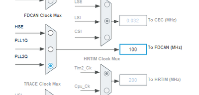

Hello @KT_Matt ,
I would suggest these timings @500kb/s for FDCAN in classic mode/ MCU running at 400MHz with an extarnal precise crystal (in your case 8MHz using STLINK MCO in Bypass mode):
I've attached the updated ioc file.
Hope it helps.

Hi @mƎALLEm ,
I tried the recommended configuration. Looks like the FDCAN is not working with this clock speed(100Mhz). It works only with 48MHz.

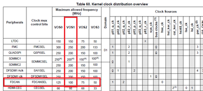

Hello @KT_Matt ,
It should work at 100MHz / System clock at 400MHz/VOS1:
Did you try Loopback mode first? Try External Loopback mode and probe with an oscilloscope or analyzer on FDCAN_Tx pin. Do you receive the sent frame?

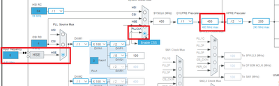

Also could you please check if the HSE is 8MHz?
For that you need to check that on MCO1 (PA8). I've attached the ioc file where I've added the output of HSE on PA8.
Could you please check with an oscilloscope if you have 8MHz on PA8?
