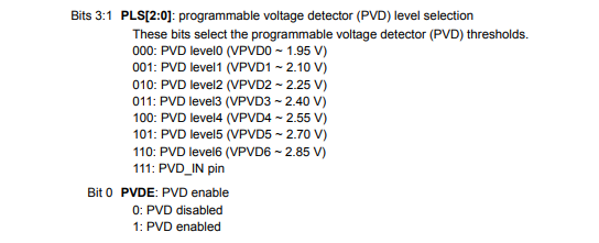

I only noticed now that you are using PWR_PVDLEVEL_7 this will connect the comparator to the PVD_IN pin (PB15). So You have to move the Voltage on PB15, not VDD.

@MHoll.2 I am working on custom hardware in which ETH_TXD1 is allocated on PB15.
Moreover, different power level connects the comparator to different pins?
No PWR_PVDLEVEL_7  is special, please read the reference manual (rm0481) chapter 10. PWR_PVDLEVEL_0 to PWR_PVDLEVEL_6 are using Vdd for the comparator input while PWR_PVDLEVEL_7 use PB15. Why did You select PWR_PVDLEVEL_7? Try selecting PWR_PVDLEVEL_6.
@MHoll.2 I understood the use of PWR_PVDLEVEL_7 and when to use. I made the required changes like selected PWR_PVDLEVEL_6 and now interrupt is being triggered.

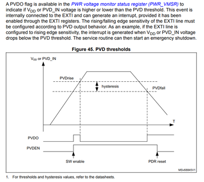

This is mentioned in the manual, so as per this if I want interrupt before RESET then I have to opt for RISING? Moreover, in my case it is working for RISING and not for FALLING.
Yes, the PVDO signal is "inverted", so falling edge = PVDrising, and Rising edge = PVDfalling:
You configuration should generate an Interrupt on both edges (to detect this you can read the EXTI_RPR1 and / or the EXTI_FPR1 register).
Be aware that You have to clean the triggered event, by writing 1 to the RPIF16 and / or the FPIF16 bit.
