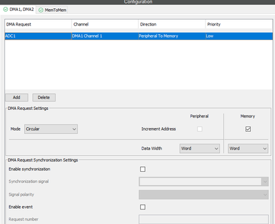

@MasterT:
DMA is configured like this at the moment:
Since STM32 is a 32-bit MCU, WORD means uint32_t, I think... It is correct?

@MM..1Okay, I've removed & , the DMA is configured as word, not half-word.
What I've done:
  • Remove the & in if (HAL_ADC_Start_DMA(&hadc1, (uint32_t *) adc_convertions, 5) != HAL_OK)
  • Changed uint32_t to uint16_t.

MasterT
Lead II
October 12, 2024
If DMA configured as Word_Peripheral- Word_Memory, than
uint32_t adc_convertions[5] = {0};  or int32_t adc_convertions[5] = {0};
correct declaration.
For Halfword_Peripheral- Halfword_Memory, than
uint16_t adc_convertions[5] = {0};  or int16_t adc_convertions[5] = {0};
Heinrich
HeinrichAuthor
October 12, 2024
Okay, then it was correct.
I've changed them back to uint32_t adc_convertions[5] = {0};

 hadc1.Init.OversamplingMode = DISABLE;
 if (HAL_ADC_Init(&hadc1) != HAL_OK)
 Error_Handler();
 /** Configure the ADC multi-mode
 multimode.Mode = ADC_MODE_INDEPENDENT;
 if (HAL_ADCEx_MultiModeConfigChannel(&hadc1, &multimode) != HAL_OK)
 Error_Handler();
 /** Configure Regular Channel
 sConfig.Channel = ADC_CHANNEL_2;
 sConfig.Rank = ADC_REGULAR_RANK_1;
 sConfig.SamplingTime = ADC_SAMPLETIME_24CYCLES_5;
 sConfig.SingleDiff = ADC_SINGLE_ENDED;
 sConfig.OffsetNumber = ADC_OFFSET_NONE;
 sConfig.Offset = 0;
 if (HAL_ADC_ConfigChannel(&hadc1, &sConfig) != HAL_OK)
 Error_Handler();
 sConfig.Channel = ADC_CHANNEL_4;
 sConfig.Rank = ADC_REGULAR_RANK_2;
 Error_Handler();
 /* USER CODE BEGIN ADC1_Init 2 */
 if (HAL_ADCEx_Calibration_Start(&hadc1, ADC_SINGLE_ENDED) != HAL_OK)
	 Error_Handler();
 /* USER CODE END ADC1_Init 2 */
 * Enable DMA controller clock
static void MX_DMA_Init(void)
 /* DMA controller clock enable */
 __HAL_RCC_DMAMUX1_CLK_ENABLE();
 __HAL_RCC_DMA1_CLK_ENABLE();
 /* DMA interrupt init */
 /* DMA1_Channel1_IRQn interrupt configuration */
 HAL_NVIC_SetPriority(DMA1_Channel1_IRQn, 0, 0);
 HAL_NVIC_EnableIRQ(DMA1_Channel1_IRQn);
 * @PAram None
 * @retval None
/* USER CODE BEGIN MX_GPIO_Init_1 */
/* USER CODE END MX_GPIO_Init_1 */
 /* GPIO Ports Clock Enable */
 __HAL_RCC_GPIOF_CLK_ENABLE();
 __HAL_RCC_GPIOA_CLK_ENABLE();
 __HAL_RCC_GPIOB_CLK_ENABLE();
 HAL_GPIO_WritePin(LD2_GPIO_Port, LD2_Pin, GPIO_PIN_RESET);
 /*Configure GPIO pin : LD2_Pin */
 GPIO_InitStruct.Pin = LD2_Pin;
 HAL_GPIO_Init(LD2_GPIO_Port, &GPIO_InitStruct);
/* USER CODE BEGIN MX_GPIO_Init_2 */
/* USER CODE END MX_GPIO_Init_2 */
/* USER CODE BEGIN 4 */
/* USER CODE END 4 */
 * @brief This function is executed in case of error occurrence.
 * @retval None
void Error_Handler(void)
 __disable_irq();
 while (1)
#ifdef USE_FULL_ASSERT
 * @brief Reports the name of the source file and the source line number
 * where the assert_param error has occurred.
 * @PAram file: pointer to the source file name
 * @PAram line: assert_param error line source number
 * @retval None
 /* USER CODE BEGIN 6 */
 /* USER CODE END 6 */
#endif /* USE_FULL_ASSERT */
Result:
  • adc_convertions[0] says 2622, correct
  • adc_convertions[1] says 2621, correct
I think the point with SB14 was the solution...
Now it fine and all the values are correct.
Thank you very much!
