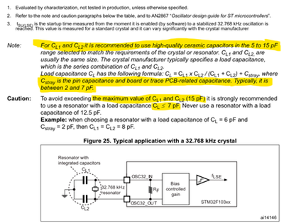

I am making this post because I have reviewed many reference schematics for the use of the STM32F103C8T6, and in most of them, I see that they use 20pF load capacitors for the LSE circuit.
The datasheet literally states that the value of the load capacitors should not exceed 15pF (considering that both are of the same value) and that the load capacitance of the quartz crystal should not exceed 7pF.
It also indicates the maximun LSE driving current (1,4uA) and the oscillator transconductance gm (5uA/V)

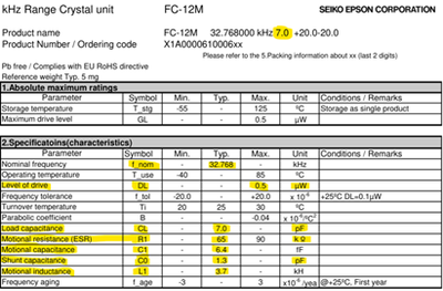

To illustrate this a bit, I have taken as an example a crystal with the following characteristics:
  • Nominal frequency (f_nom): 32,768 Khz
  • Drive level (DL): 0,5uW
  • Load capacitance (CL) : 7pF
  • Motional resistance (ESR) typ: 65Kohm
  • Motional capacitance (C1): 6,4fF
  • Shunt capacitance (C0): 1,3pF
  • Motional inductance (L1):3,7kH

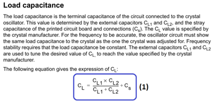

Assuming that Cstray in double-sided circuits ranges between 1pF and 2pF according to this post: https://community.st.com/t5/stm32-mcus-boards-and-hardware/stm32f103c8-production-board-schematic/m-p/140427#M4538 the formula would be like thefollowing (CStray = 1pf):

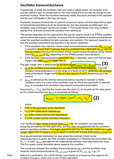

Oscillator trasconductance:
Cgelectronics_9-1720263027714.png < 1uA/V
Cgelectronics_10-1720263279793.png   > 5

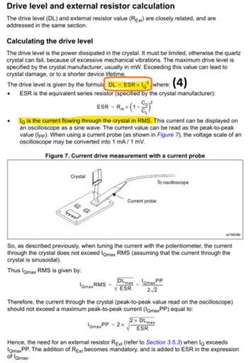

Drive level:
Cgelectronics_11-1720263438176.png < 0,5uW
Taking all of the above into account and according to the calculations I have performed, the maximum capacity that the crystal load capacitors could have would be 14pF assuming that C_stray is 0 and that the quartz crystal has a CL of 7pF. Therefore, I don't understand why the schematics have 20pF capacitors for the LSE circuit. Below, I indicate some reference schematics:

Dear @Cgelectronics ,
Thank you for the detailed question and here is my reply - I was among the original contributors on the very first AN2867 and also we produced billions of STM32 MCUs where most of our customers are using our LSE with the very famous tunning  fork quartz 32,768KHz . Before our Introduction of STM32F103 MCU in 2007, the reference crystal CL is at 12,5pF to have a robust industrial and very low pullability Clock . STM32F103 is optimized for low power operations including VBAT mode and added a circuitry that supports maximum CL = 7pF , believe me it was a revolution at that time … no more now and we worked with all crystal partners to have standard parts crystal and high runner at market with CL=7pF , 6 pF and compact size for PCB . Today they are standards.
Back to you question : “Taking all of the above into account and according to the calculations I have performed, the maximum capacity that the crystal load capacitors could have would be 14pF assuming that C_stray is 0 and that the quartz crystal has a CL of 7pF. Therefore, I don't understand why the schematics have 20pF capacitors for the LSE circuit”
=> This absolutely correct and right . Never CL1 and CL2 should exceed 14pF for a 7pF crystal  and in reality with a Cs=2pF it should not exceed 10pF to operate as you expect.
That means the real frequency will be the closed in terms of PPM to 32,768KHz  and so drift will be minimal.
Taking into account of course the startup condition of GM and Gm crit as you explained.
using 20pF will work if GM is satisfied in nominal condition as a crystal ESR is always typical and our formula is based on ESR Max computation - high or very low temperature and all VDD range 2Volts to 3,6Volts. But if the crystal CL=7pF the oscillation frequency will be slower than 32,768KHz and with +100 to 300 PPM is some cases instead of +50PPM .. many applications do not care of the frequency drift such as consumer as they calibrate it by digital with RTC registers or synchronize with BLE etc.
