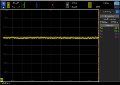

I'm using the STM32H7B3.
ADC configuration:
Sample time : ~2us
LL_ADC_SAMPLINGTIME_64CYCLES_5
Calibrations:
HAL_ADCEx_LinearCalibration_FactorLoad(adc2)
HAL_ADCEx_Calibration_Start(adc2, ADC_CALIB_OFFSET, ADC_SINGLE_ENDED)
Observations:
The ADC counts seem to be stuck at values which are highlighted in the picture above at around 0.31 to 0.35 V and 0.62V to 0.66V
The ADC > DR also seems to be stuck and reads 255, 511 at the two voltage ranges mentioned above
Input signal source:
Analog Input voltage range is 0V - 5V in YELLOW converted to 3.3V scale which is also the Vref
Using only RED boxed channel that is connected to the ADC pin on the mcu
Things that I tried:
  • Increasing the sample time to ~11us
  • Tried different calibration combinations HAL_ADCEx_Calibration_Start(adc2, ADC_CALIB_OFFSET_LINEARITY, ADC_SINGLE_ENDED)
  • Ignored the DMA buffer values and only observed the ADC > DR which also seems to directly jump from 255 to 288 and 511 to 544
Nothing changes and it's repeatable
Any suggestions would be helpful
Thank you!
Sahiel
This issue was resolved when the F_adc which was 35Mhz was reduced to 6.25Mhz

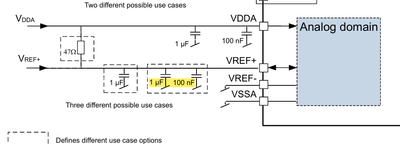

How is VREF+ connected? If you skip a cap here, or if it's unstable, you'll get readings like this.
Sahiel
The Vref+ has a 1nF cap and it seems to be stable
The recommendation is 1 uF + 100 nF. The 1 nF isn't doing much.
Sahiel
I'm gonno try changing the caps and get back!
Thank you!
