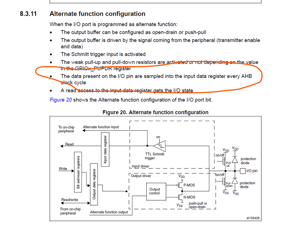

Actually I change like below just a test . But GPIOA-> ODR data always zero doesnt change.
USART1 TX pin is connnected PA9... And it transmit data. But GPIOA-> ODR value doesnt change.
I think GPIO ode in AF mode doesnt change ODR register status. Is there any way to read Pin state in AF Mode ????

‎2020-05-09 5:27 AM
I don't know, you have to dig the reference manual.
‎2020-05-09 5:32 AM
In the Referance manual , it 's written . Below code Works For Nucleo F401RE
if((GPIOA->IDR & GPIO_PIN_9)!= 0)
HAL_GPIO_WritePin(LD2_GPIO_Port, LD2_Pin , 0);
}else
HAL_GPIO_WritePin(LD2_GPIO_Port, LD2_Pin , 1);
