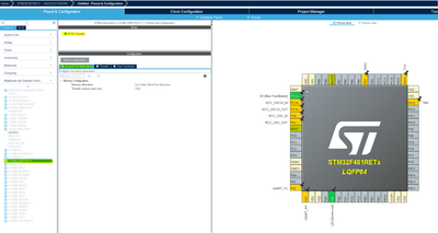

"I successfully ran a simple Azure RTOS task using nucleo-f429zi, stm32cubemx, and iar ewarm 9.30. However, when I apply the same method to nucleo-f401re, it gets stuck in the tx_thread_sleep function. It seems that the OS Tick interrupt might not be occurring properly. Therefore, I have the following questions:
  1. Why is it possible to use Azure RTOS easily with stm32CubeMX on Nucleo-F429ZI, but not on Nucleo-F401RE?
  2. What could be the cause of this issue, and how can it be resolved?"

I've resolved the issue. The problem was due to the NVIC's "Priority Group" being set to "0 bits for pre-emption priority, 4 bits for sub priority". After changing the setting to "4 bits for pre-emption priority, 0 bits for sub priority", everything started working properly.
On Nucleo-F429ZI, when adding Azure RTOS, CubeMX correctly sets it to "4 bits for pre-emption priority, 0 bits for sub priority". However, on Nucleo-F401RE, when Azure RTOS is added, it defaults to "0 bits for pre-emption priority, 4 bits for sub priority", and I'm not sure why.

Could you please precise which STM32CubeMx version are you using?
You can use X-CUBE-AZRTOS-F4 using STM32CubeMX 6.11.1 and Nucleo-F401RE as shown in the below figure.
