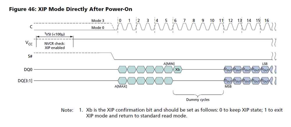

It seems you've used wrong byte order: "The WRITE NONVOLATILE CONFIGURATION REGISTER operation must have input data
starting from the least significant byte.". So, your test_buffer[0] went to bits 0 to 7, and test_buffer[1] to bits 8 to 15. This means
"XIP: Quad output fast read" is active at power up. See the chapter about "XIP Mode" in datasheet to get out of XIP mode, afterwards you can reprogram the configuration register.

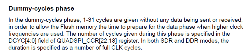

Thank you for your answer, as you suggest, I looked into exiting XIP mode and found out that I do so "by driving the XIP confirmation
bit to 1."
"This bit is the value on DQ0 during the first dummy clock cycle in the FAST READ operation."
I don't really understand, how can I set this bit in dummy cycles. On the contrary, there is a point made, that there can't be anything during dummy clocks cycles.
From RM0399:
0693W00000GXx4CQAT.pngDid I misunderstood something? Is there any way to set this confirmation bit on STM32H745?
That's what the "Alternate Byte(s)" phase could be used for. Of course, the number of dummy cycles in DCYC field has to be reduced accordingly.
For the flash, the dummy phase is rather irrelevant, the QSPI could simply continue to send dummy data or receive and discard dummy data, except that there must be some "bus free" time for turnaround
Thank you very much, it worked as you suggested. After setting confirmation bit, I was able to change nonvolatile configuration register, restoring default settings. Memory work as intended.
