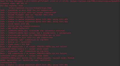

Accessing an SD card through SPI with a STM32F411RE board
deta
Hello everyone. I am getting started with SPI and am here with what I believe to be a pretty simple mistake or oversight on my part that I am just not seeing. For the first part of this project, I wish to create a file named "write.txt" on my SD card using just my code in the NUCLEO-F411RE [though I believe the board I use doesn't make much of a difference as long as it is in the STM32F family(?)]. I am using SPI1 for this project (I disabled the LED attached to the SCK pin) and have decided to use pin PB2 as my CS--set the pin as a standard I/O). Here is my code:
my main.c file:

What I get on the console when I run this code:
(I have changed the speed).
I know for a fact that this is a tall order for anyone, I was just hoping that a person with more experience knew a better way to go about this. I have the sneaking suspicion I have made this into a far more complicated task than it truly is, I would appreciate any criticism and resources you can spare.
