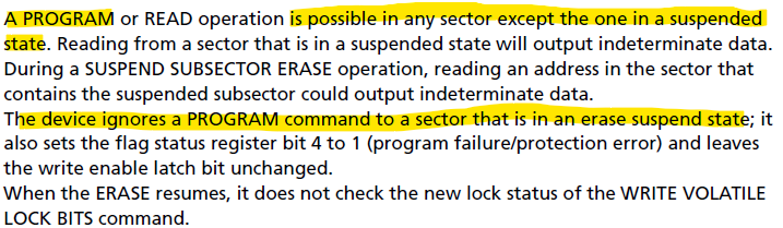

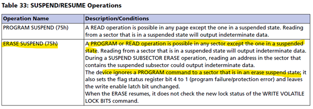

The documentation of flash is confusing e.g. in the MICRON flash, which is soldered on the STM32H753_EVAL board, it seems there is difference in sector erase and erase command:

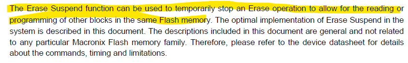

The MACRONIX AN0247 says that programming is allowed

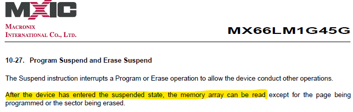

but the datasheet says that only read is allowed in suspended state
Any experience here, has anybody checked this out?

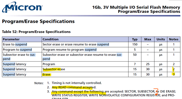

Got my suspend/resume test working. I experienced two problems with the MT25QL. First, writing to flash after erase suspend works not for 4kB sectors. Now I use 64kB sector erase. Second, the program must wait for the WIP bit cleared after erase suspend before issuing a page write. It is not sufficient to wait for the erase suspend bit set only. The MT25QL maintains a negated copy of the WIP status register bit in the flag register. So both bits must be verified by reading the flag register. First I did not wait for WIP cleared and the following write did not succeed. The write seemed to be ignored because the program failure bit was not set.

first I stuck on RWW flash (MX25LWxxx) to perform write-while-erase.The problem seems to be that there is only one charge pump, you can erase or program only but not both at the same time.

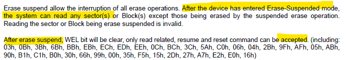

I switched to write-while-erase-suspended but to my surprise, it seems the feature is not supported by MACRONIX, at least not at the high density flash, e.g. MX66L01G.
Page Programm commands are not supported (02h, 12h, 38h, 3Eh) but RSTEN and RST 66h/99h.
If the flash does not support write-while-erase-suspended, a flash reset and re-init might be workaround.
My hope now is that write-while-erase-suspended is supported by MICRON e.g. MT25QL01G:
