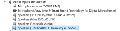

i use stm32h750 as a decoder to translate use audio data into i2s 16bits 48khz data.however, when i use usb_otg_fs
, everything works properly,but when i use the same configration and only switch to usb_otg_hs,some problem has occured. i use usb3300-ezk as the external PHY, which can communicate with my windows11 laptop through a type-c
cable.the computer can detect stm32 audio class and bus hound shows the det description progress run correctly and then system send set interface 0, when i try to display music, it sends set interface 1 for several times but meet xact error.i noticed that something may related to the main clock and usb clock, but i cant find the right settings.

After i set the ULPI gpio pin to very high, the problem still there. and i've checked the example but dont know how to use it, because it seems like not created by CubeMX.
Additionaly, if all the process work properly but only the last step wrong, what does it main. I see the GET DESCRIPTOR; SET CONFIG ; GET DESCRIPTOR; CLASS REQ 81 ; SET INTERFACE.And after then xact error occurs, i dont know why only this step failed.
