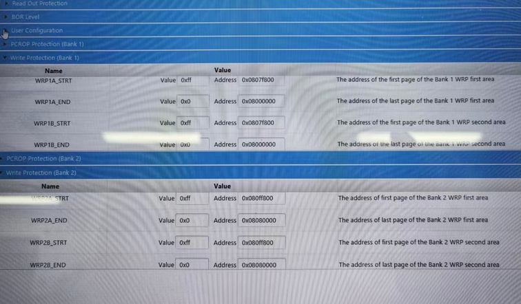

Huiqi
Hello @Saket_Om
Here is the protection area definition read from STM32CubeProgrammer, and it seems address 0x08021800 is not in the protection area.
Best Regards,
By the way, I also try HAL_FLASH_OB_Unlock() in firmware, and the result is same.
