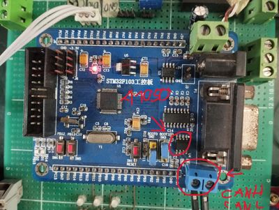

Hi. I'm new to STM32, and I'm using STM32F103C8T6. I want to run Loopback mode to test CAN BUS without another board first. When I go to debug, I find it stuck at HAL_CAN_START. It returns error code 131072. Can you guys please help me find out the problem? I also give the main.c below. Thanks for reading.

What board are you using? Blue Pill?
Dang_VAA
Yes. It's not actually a Blue Pill. But that kit uses the same chip (STM32F103C8T6) as Blue Bill. The kit includes transceiver A1050. PB8 and PB9 are used for CAN_RX and CAN_TX pins. When I use PA11 and PA12, it's still OK. But when remapping to PB8 and PB9 with the same code, it gets stuck, as I said.
In next time please use </> button to share your code:
1- Did you modify the hardware on the board to connect the new CAN pins to the transceiver? if yes how you did that?
2- Share the schematics of the board and tell what you have modified on it?

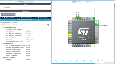

These are bad CAN bit timing parameters:
hcan.Init.Prescaler = 18;
hcan.Init.Mode = CAN_MODE_LOOPBACK;
hcan.Init.SyncJumpWidth = CAN_SJW_1TQ;
hcan.Init.TimeSeg1 = CAN_BS1_2TQ;
hcan.Init.TimeSeg2 = CAN_BS2_1TQ;
Avoid using 1TQ to set one of the bit time segments.
Please read this article: CAN (bxCAN) bit time configuration on STM32 MCUs :
1. First, I use STM32CubeMX to modify CAN pins. I activate CAN, then remap at Pinout View.
2. The kit I borrowed from my mate. And I have searched the web for the schematic, but none match that kit.
I use VOM to find out where the TX and RX on the transceiver are connected to.
Ok. Thanks for pointing out my fault. I changed that too. Now, how can I find out what my problem is?
If you didn't change the hardware and remap the pins also in your board to correspond to what you have implemented in the software, that obviously won't work.
I'm pretty sure that I remapped the pins and set bit time segments as you advised. Also, I found and followed your instructions to set up a CAN demo using this link: https://community.st.com/t5/stm32-mcus/guide-to-can-bxcan-can2-0-configuration-in-loop-back-mode-on/ta-p/771119

Based on your first statement: "PB8 and PB9 are used for CAN_RX and CAN_TX pins. When I use PA11 and PA12, it's still OK. But when remapping to PB8 and PB9 with the same code, it gets stuck"
I'm almost sure that's a hardware issue. As I don't have all the hardware elements nor the schematic details, I cannot help you at this stage.
